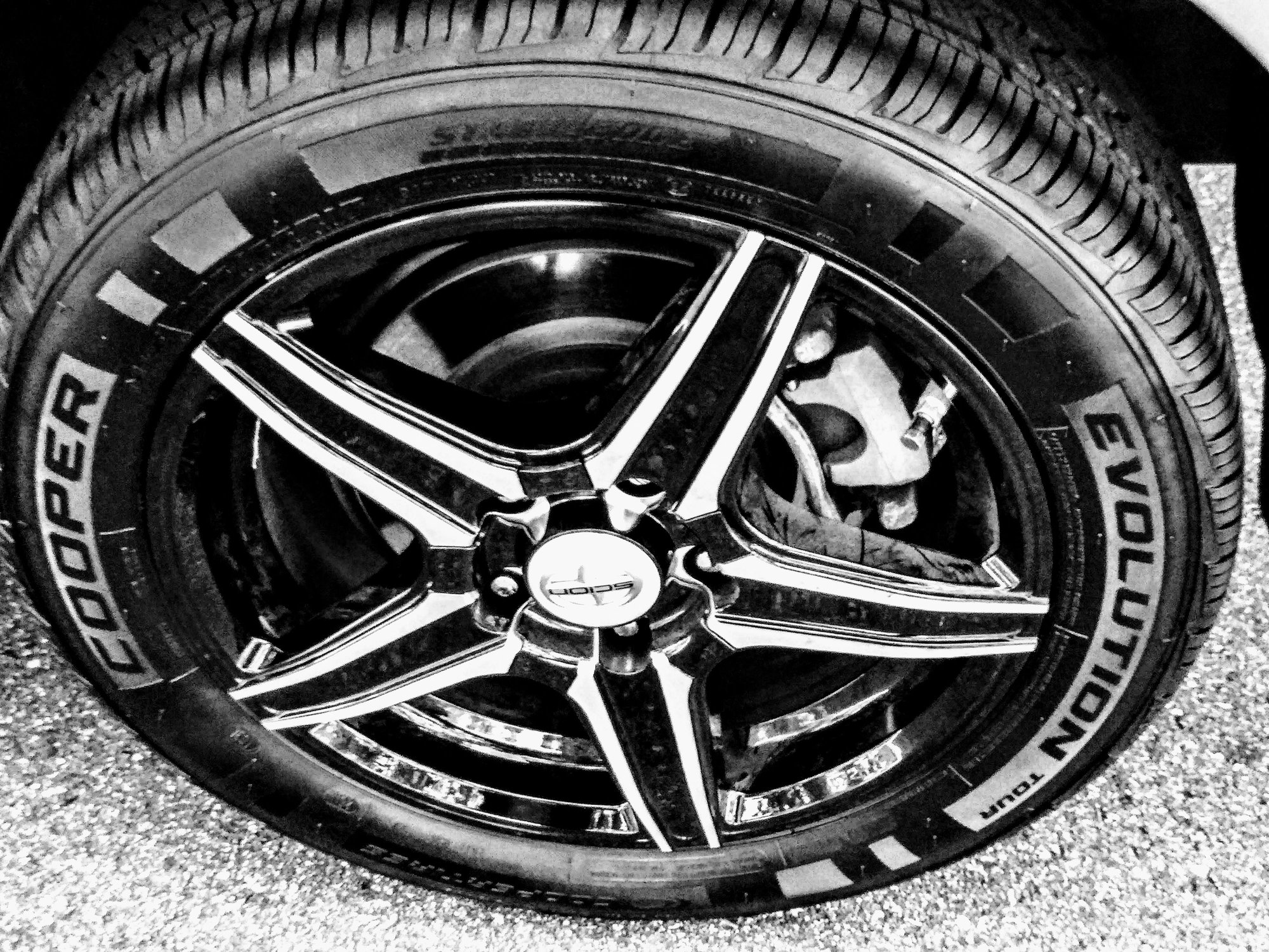

Interesting post. I have a 2015 Gen2. Mine does not have the reset illustrated in the link, or the TPMS light. Did all Gen2's have TPMS? I have attached a picture of my wheels that came with the car when I purchased it. I've not seen these wheels on another,
are they a Scion option or simply an aftermarket with a Scion center hub emblem attached? I've done exhausting searches for these wheels without any results. These wheels do have a metal valve stem, if that's any indication of TPMS? Thx
Don't know about the wheels but... "In the United States, as of 2008 and the European Union, as of November 1, 2012, all new passenger car models released must be equipped with a TPMS." Your Gen2 has to have it.
Yes, you had TPMS sensors stock. The reset button is under the driver's side of the dash on the right hand side near the center console. Two option on if you have TPMS. Either yes you do and it has just never needed to turn on, or the previous owner removed, or taped over, the bulb in the dash. Easy test would be to let about 10 psi out of one of the tire and drive on it for a short distance. The light should come on if you have TPMS sensors. If it doesn't then something has been done to get rid of the indicator light.
No, those are not stock option wheels. They just have Scion logo center caps added to them. If you take one off the manufacturer should be stamped or label on there.
I check/adjust my tire air pressure monthly. This habit is from riding motorcycles, so when I fire up the compressor I simply check everything. Suppose it's never needed to illuminate, due to the constant monitoring I do. I am detailing my Xbox this morning. Going to let some air out and check it for proper operation and will pull one of the Scion Logos off a wheel and solve my mystery.
