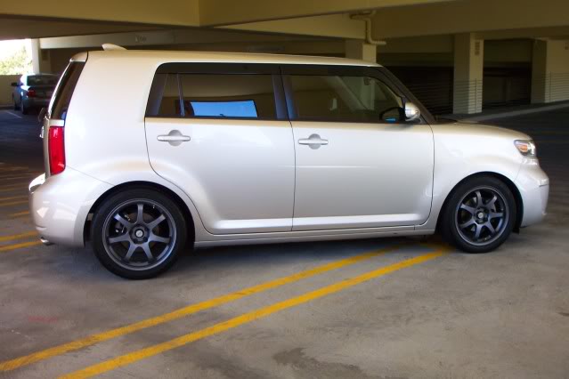

Cionide post a pic here , so i can see what it looks like with the different side wall height please.
Old Mar 5, 2011 | 05:32 PM
CIONIDE's Avatar
Posts: 6,012
From: Napa, CA
If you're talking about mine, the front and rear are almost the same sidewall height, even though the tire diameters are almost an inch apart, because I'm running 17's up front and 18's in the rear. Here's my full story and a pic:
CIONIDE finally gets new shoes & socks!
https://www.scionlife.com/forums/sho...d.php?t=166074
