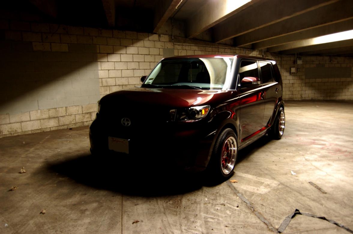

So I'm looking at these wheels for my box in 18". I wanted to know a few things:
- Will these fit with DF210 springs?
- What's a good fitment so they are flush with the fender but tuck in just a little bit?
- If these won't work, then what's a good wheel that fits this style that will work?
I found a pic of a BSP with these wheels but I can't tell what he is dropped on and it doesn't say. Here's the pic:
I like the look of this car except it needs a little more drop so the tires tuck just a little bit.
I don't know anything about wheels so I need help from the best.
Thanks!

Those wheels are only available with +15 offset in 18's. The wheels will stick out past the edge of the front fenders by more than 1/2" and it would take some crazy stretched tires to try and keep from rubbing on a DF drop.

haha. that's my car up there man. those are 512's 18x8 +15 offset. I run 225/45 18's on all 4 corners. I'm lowered on DF210's and TRD struts. It rubs a lot in the rear even with just 1 person in the back, so I had to roll and then pull my fenders. Here's how she sits now. Sorry for the crappy pic, all I have is my iPhone.
I powdercoated them bronze, polished the thin outer lip (cause i curb them alot), and i applied a thin red inner lip line. I'm about to powdercoat them gunmetal, but who knows when I'll have the cash for that.
Cionide is right, it's all in the offset of your wheels. If you don't want to rub, you might want to look into a higher offset wheel so they sit closer to the hub. But if you love this look (like I do), you'll have to sacrifice doing some crazy fender work to it. Hope this helps.

well i rolled them 3 times total with the fender rolling tool, and even though it looked flush, it still rubbed. So i had to go past flush (which means pulling) and now the fender sticks out in the back. It wasn't that hard rolling and pulling, it just took a lot of time cause if you rush it, the paint cracks and then rust will form. So be careful. It doesn't rub anymore even when the rear is fully loaded with people or things. Too bad I'm getting rid of this thing pretty soon...
