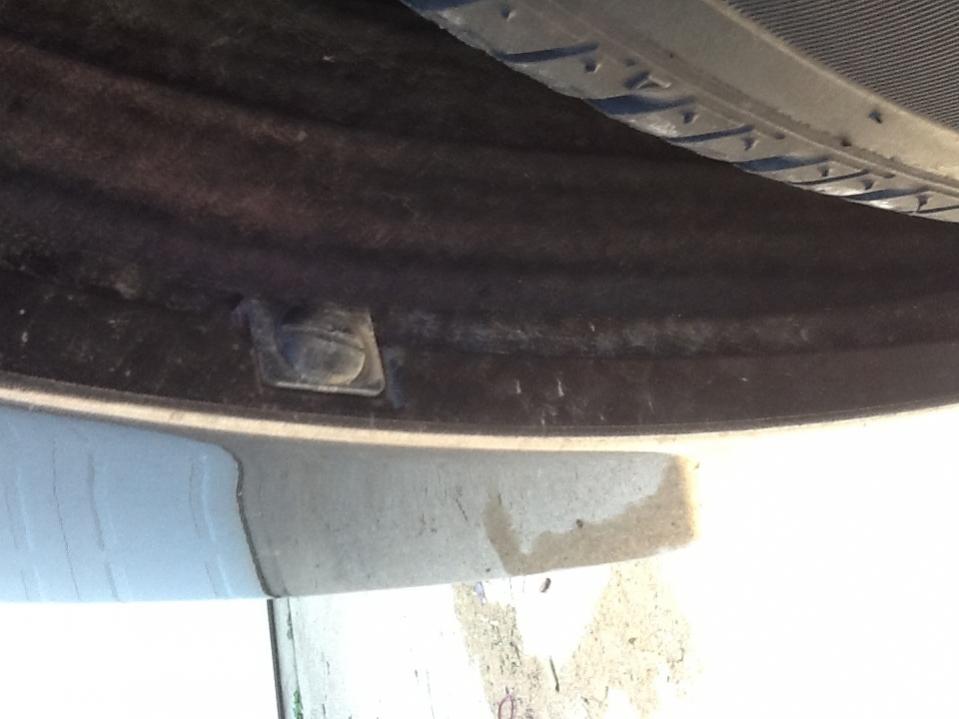

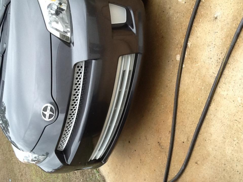

Yeah I did the same thing and painted mine. Once you pull the bumper off they have slot clips to hold the grille and lower grille on. I'll try to get a pic posted.
Old Jan 13, 2013 | 05:26 PM
Bmoney's Avatar
Joined: May 2012
Posts: 9
Check and see if this works.

Old Mar 18, 2013 | 07:43 PM
Bmoney's Avatar
Joined: May 2012
Posts: 9
More to come

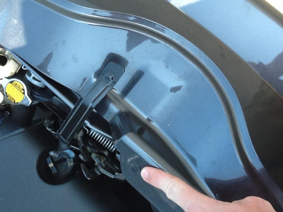

Old Mar 18, 2013 | 07:44 PM
Bmoney's Avatar
Joined: May 2012
Posts: 9
Another
