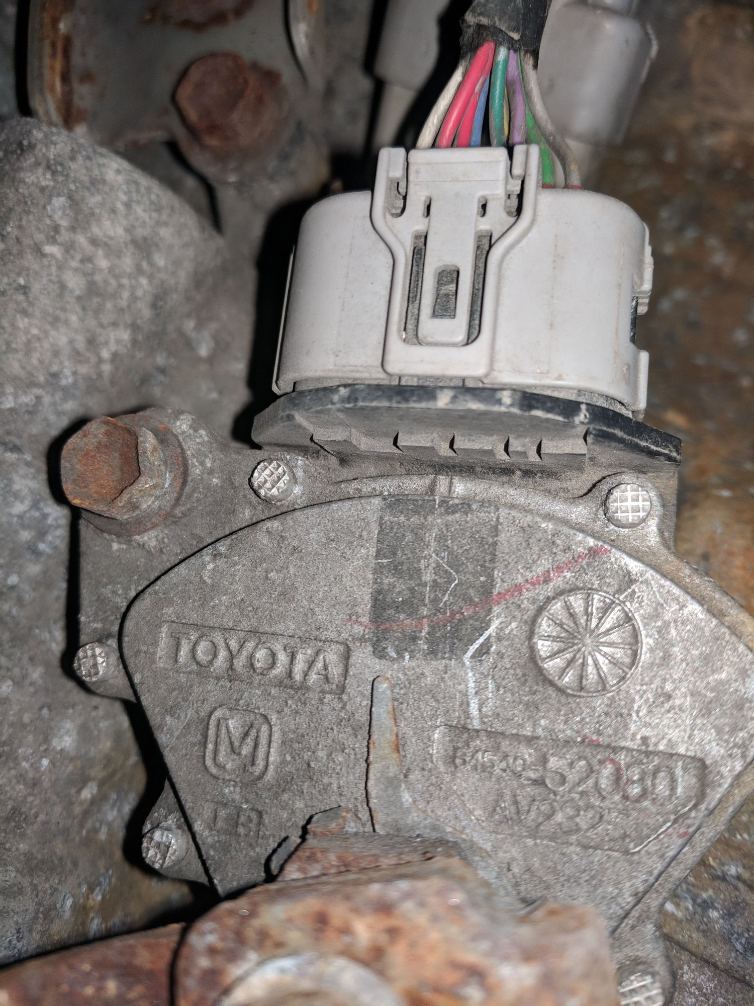

Here is a photo of the Neutral Safety Switch, which the shifting arm goes through. New ones cost almost $200, and I hate to just go buy one, when I have no idea if it could be causing the problem?
Photo of Neutral Safety Switch 2008 Scion xD automatic.

So, you can start the car in neutral? If so, then the neutral safety switch is NOT the problem. If you can put the lever into the park position, but the parking pawl does not engage, then you've either got a broken parking pawl, or a stripped flywheel. Has anybody thrown it into park while moving?
