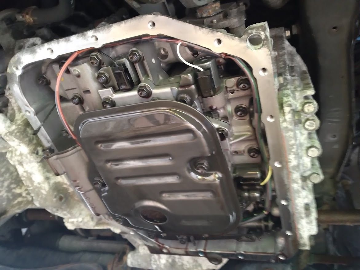

Now, you can opt to remove the filter, or inspect the pan and mount the new rubber gasket.
I opted to take out the old filter first, very simple, held in by three bolts. You will need to observe where the "O" ring on the old transmission filter is and make sure to remove it, mine fell into the pan on the removal of the filter. The point is to account for it. I could see it because I use a shallow drain pan with a plug, which I also recommend.
Next, I installed the new filter.
First I used a bit of ATF fluid on the new "O" Ring and slid it over the stub on the top side of the filter to get a proper seal.
youtu.be/Py_PFOPaOaE?si=ZPrYwltfUTALAzyt&t=278
This is critical.
Next, I hand-tightened the three bolts, don't worry about orientation, there is only one way the new filter can face to line up with the bolt mounting holes. Just make sure to note the top and bottom orientation when you take out the old filter.

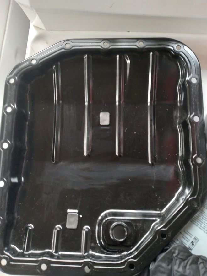

With the bolts tightened and a new filter installed, I next noted the condition of the elements in the pan. Two magnets are tucked into two indents on the slanted and flat surfaces of the pan, and what you don't want to see is an excessive amount of filings and metal shreds, I was pleased to see that I saw little or nothing "captured" in the pan.
If you DO see a lot of shiny metal fragments it might be advisable to stop and have a pro transmission shop check it.
Noting no metal shreddings or filings, I used brake cleaner to soak some shop towels, thoroughly wiped out the pan interior, as well as cleaned the mating surface the gasket sits on. Note the pan side has a ridge running around the circumference of the pan, it is designed to press and the rubber gasket evenly.
