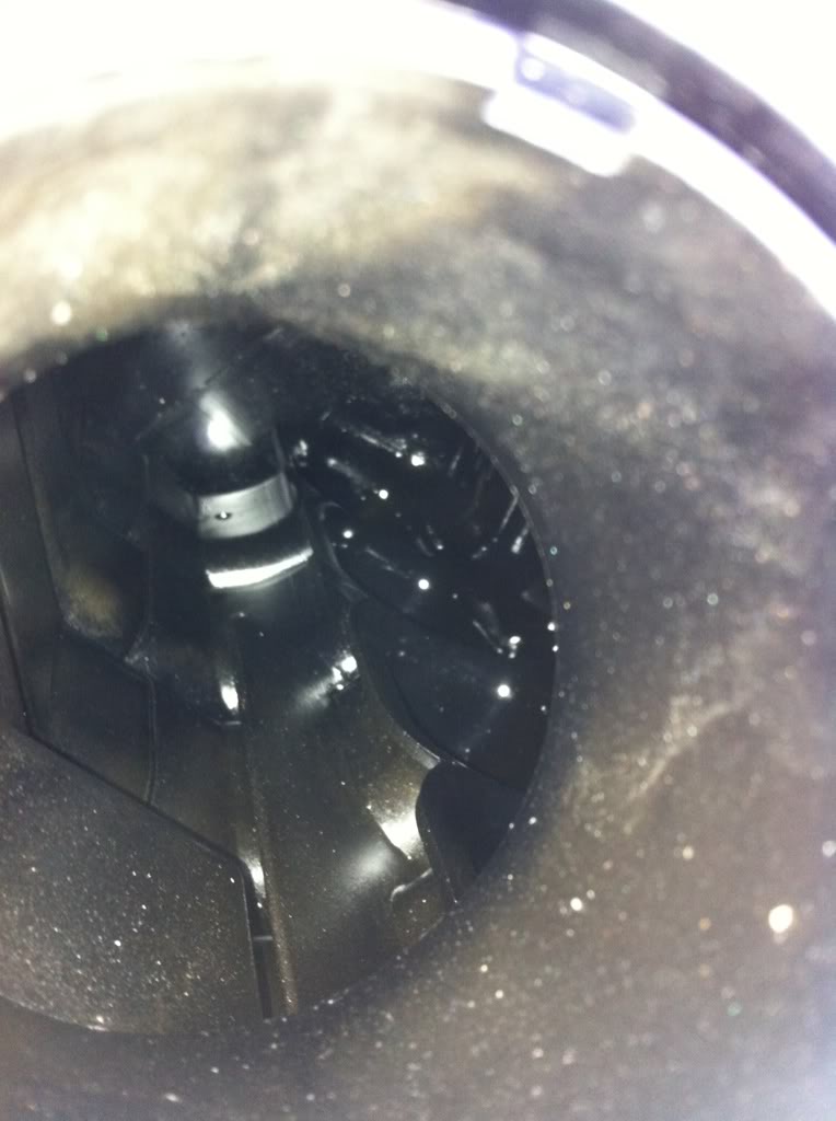

I went up to JE import performance, and didn't have great luck. They were professional and very knowledgeable. They had it done in the time they quoted me, and they made a good looking product. This version has short straight runners, no velocity stacks, but they tapered the runners. The fit was almost perfect except it rubs the bar that latches hood down. Since I don't live close, and I had to get back Chattanooga I didn't ask them to modify it any. I felt like they would if I had asked, but time was a factor for me. In the dyno results, the car gained power low, but lost HP and a gob of torque when the vvti kicked in. Then it gained again above 5k rpm. I was surprised at the stock numbers I had because I expected a few more HPs from what I had done previously to my car, but I'll chalk it up to needing to clean the filter and the heat ( it was a high of 101 when I left). I had 10 hours of driving to get familiar with the unit (drive home), and was hoping that the ECU would get use to the changes, but it never did. It's hard to butt dyno, but I defiantly noticed the lack of power where the vvti would kick in. I'm still happy I did it because the journey itself was fun, and well just because I tried. I do think the intake manifold could be updated from stock, but I'll have to wait and hope.

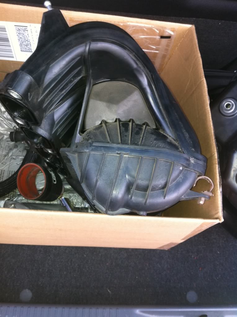

More pics
Here you can see how short the runners are compared to stock
Here you can see the velocity stacks on the oem intake.
