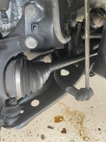

The other day I noticed a stain in the driveway near the passenger front wheel. I figured it was the caliper seal leaking.
I just took it apart and all is dry in there. Lines look dry as well. Axle, frame and inside wheel well are soaked with brown oil.
Any ideas?

OK, I'm an idiot. I put some cardboard on top of the axle and started the car. That's when engine oil started dripping. Only when engine is running and a few more drops after I shut it off.

Found the leak. Right out of this hole. Oil Pressure Switch?
