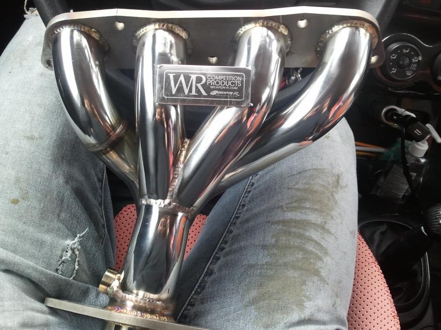

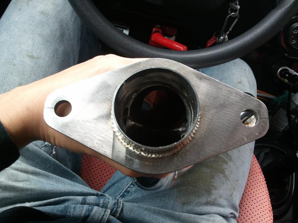

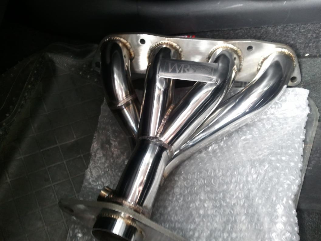

here are some pics of the header i am hoping to install it on Sunday
Damn that looks nice!! Thanks for posting pics. Let us know how the install goes...

That's just a beauty, their welds are sweet. Let's see the install!
