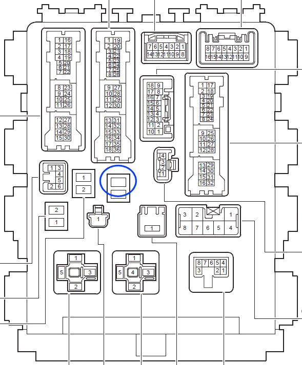

Thanks! It was pretty easy, really. I had already run a 12 gauge wire from the fuse box (in front of your left knee as you are driving) to the spare tire well. I use this to power my trailer lights. There is a 20 amp fuse in the line. The power comes from here:
The ground wire is attached to the top most nut for the left tail light. I simply attached an eyelet terminal and tightened it under the nut.
The power wire runs under the door sills on the drivers side, then behind the trunk panel, and comes out by the spare tire (right under where I installed the outlet). At that point, it splits to go to my trailer light power converter (which most people won't have, obvously) and also to the 12v power outlet. Installing the outlet was really easy -- just drill a 1 1/8" hole in the plastic panel, fish the wires through (first through the backing nut for the outlet, then through the panel), attach the wires to the outlet (using crimp-on spade terminals), then stick the outlet in the hole and screw the backing nut onto it. Done!
