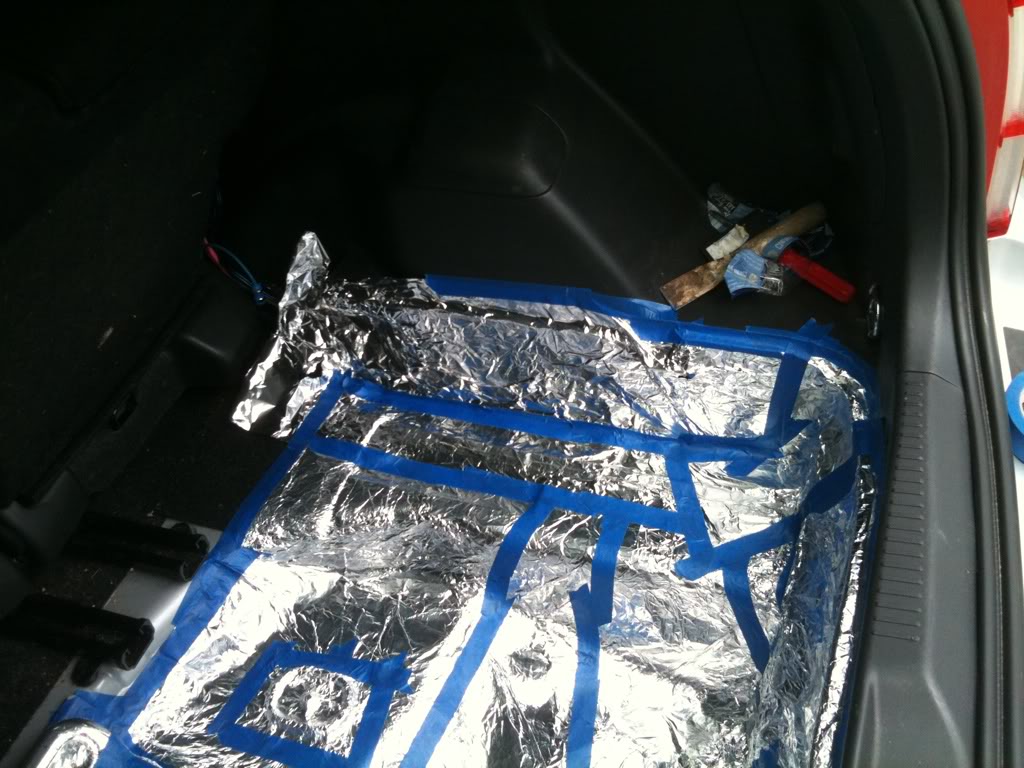

First: No longer using the T1000-1bdcp. Sold that and bought a T1500-1bdcp. Birthsheet said 19xx watts total.
Box: Not done yet, almost though! It has a fiberglass bottom and MDF top. Pictures!
Aluminum foil to keep resin from sticking to the car.
MDF bottom side panels fiberglassed into the sparetire mold:
3 sides cut and molded into the fiberglass bottom.
4 sides cut and molded into bottom and test fit to make sure:
After that I layered about 2 more layers of the thin fiberglass cloth and then added about 3 layers of the thicker fiberglass mat. Bottom of the enclosure is very solid. It supports me doing push ups using the enclosure sides as handles.
