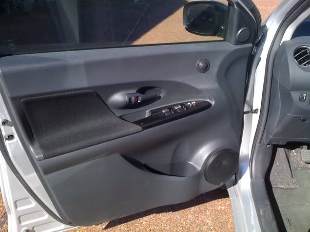

Doors

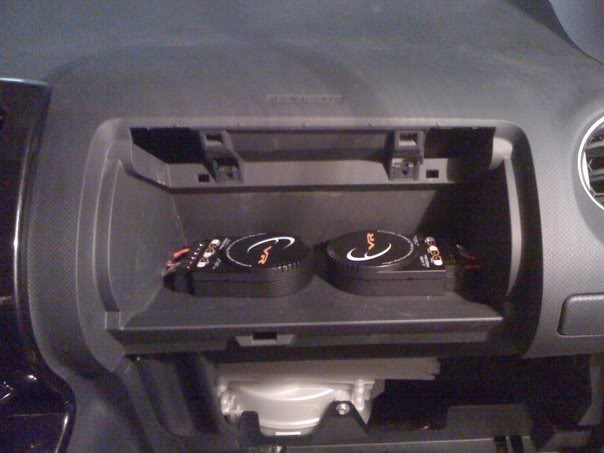

Upper glove box (now hold xovers)

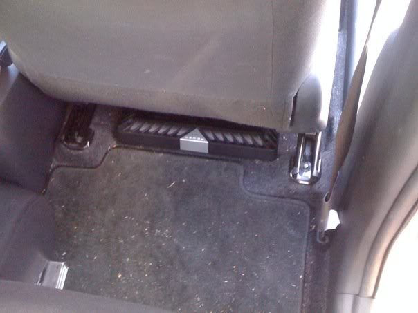

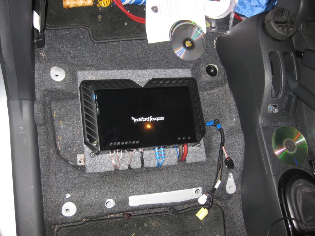

Amp with seat in normal position
Amp with seat all the way forward

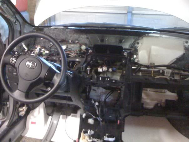

Dash? What dash? All this to get the power wire from the battery.

That seems like a ton of work to run a positive wire, you couldn't just drill a hole through the firewall?
Old Nov 30, 2009 | 12:19 AM
Swbari00's Avatar
Joined: Jun 2008
Posts: 237
From: TN
It wasn't just to run the wire, I wanted to stop the rattles as well. Not only that, it is really quite easy to take the top half of the dash off.

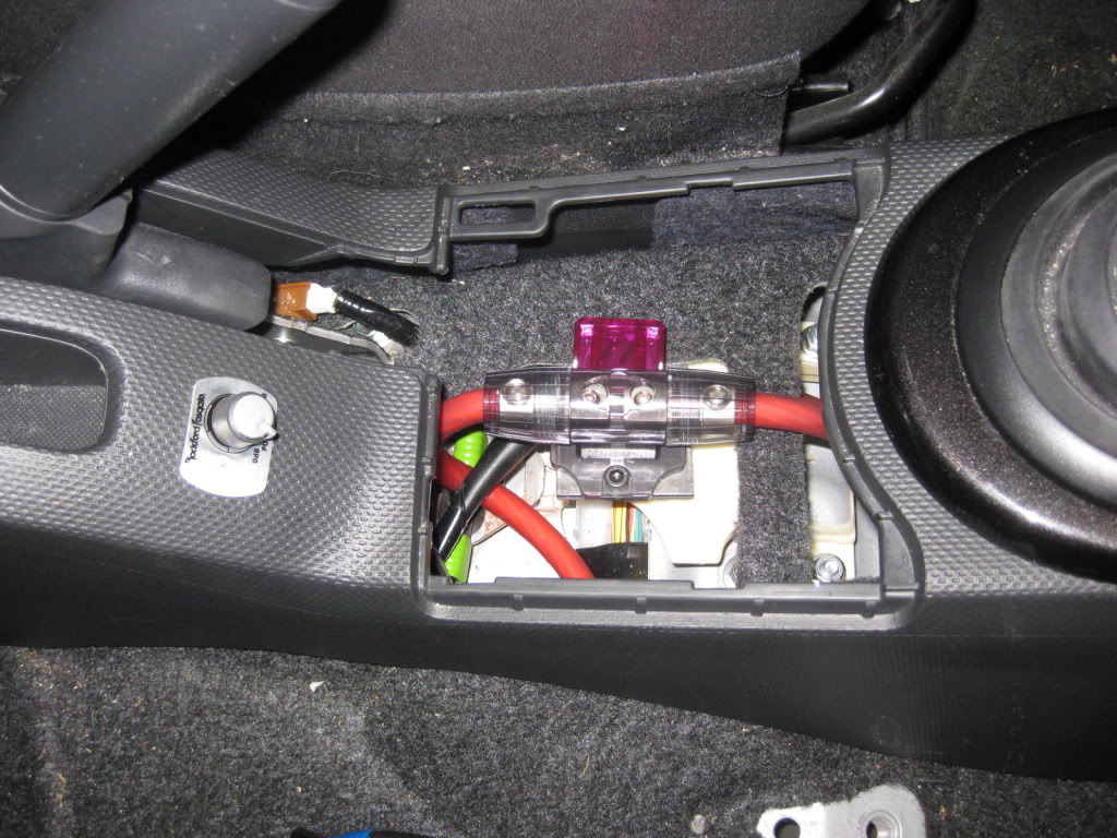

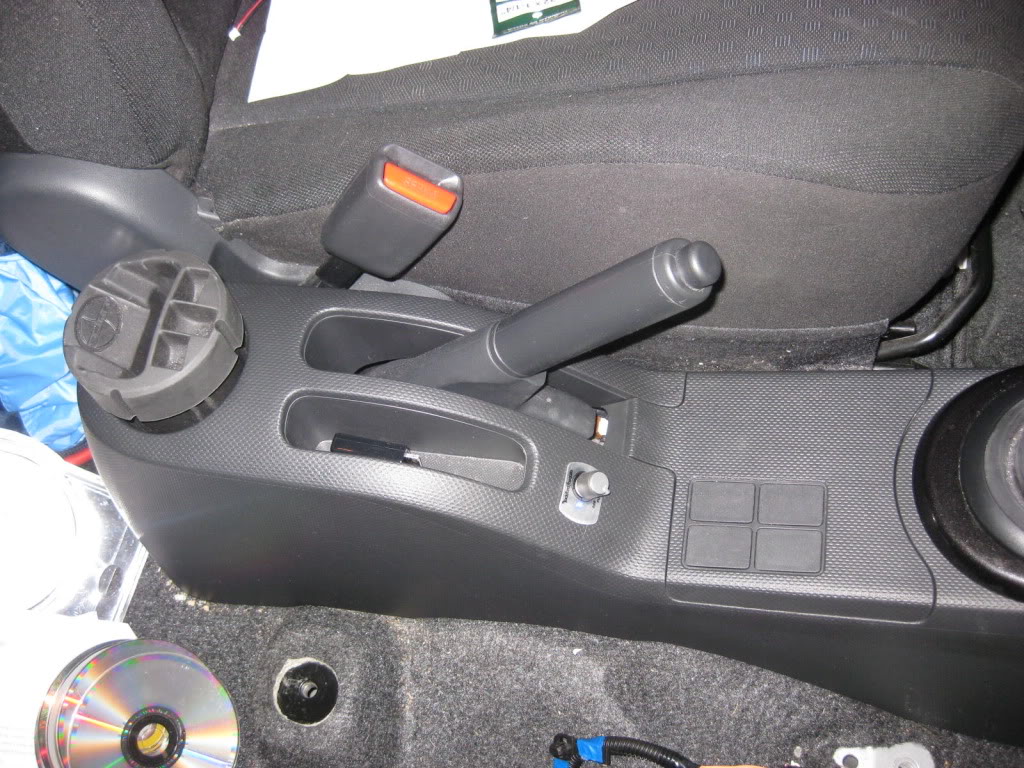

Got some more work done. I have purchased a new sub (JL 12W0v2) to replace the 8s you see here. The 8s have had the surrounds replaced and they are too small. The surround doesn't stretch far enough so when I turn up the volume the cone/coil doesn't stay properly aligned. Aside from that, it sounds great. Got the bass **** and 100 amp fuse in the center console area and the amp rack finished.

Amp rack (under seat that isn't there)
Bass ****
Bass ****
Fuse

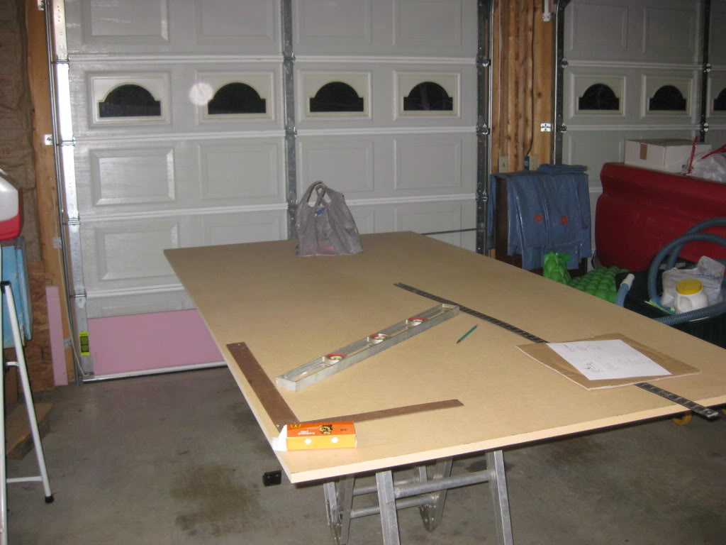

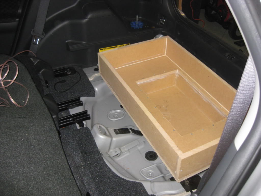

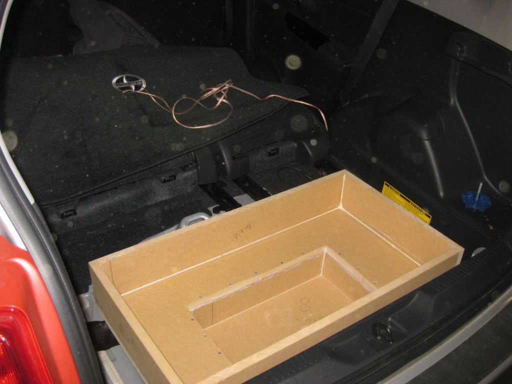

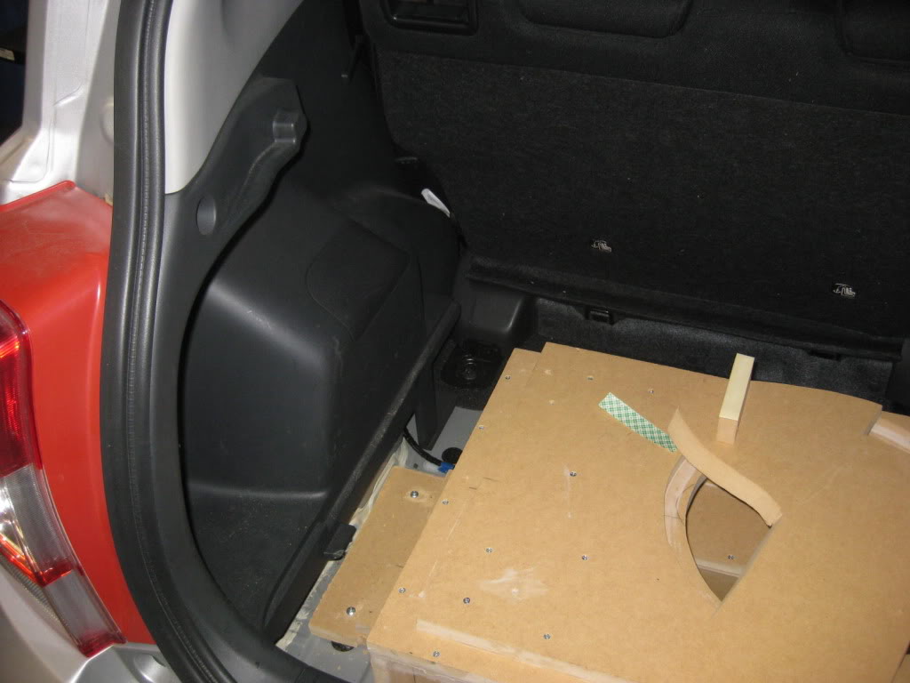

Ok here goes. This is my first attempt at making a box that is something other than a rectangle. I should also mention I have no table saw or router, so circular saw and *gasp* jig saw. First flush mounting attempt and first false floor so be nice. I have no trim pieces yet but here is where the box stands now.
(Is there a way to rename a thread? This is not really about my seat any more. )
Blank wood:
No baffle, in car:
No baffle, in car (different view):
Test fitting pieces:

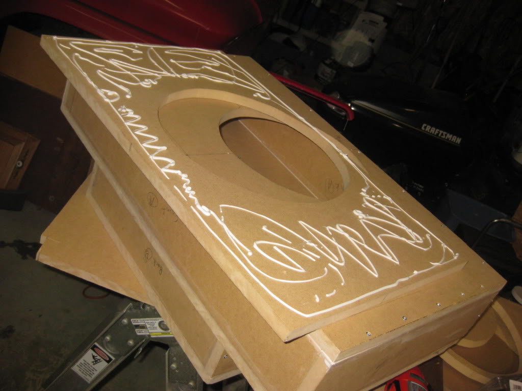

Liquid Nail FTW:

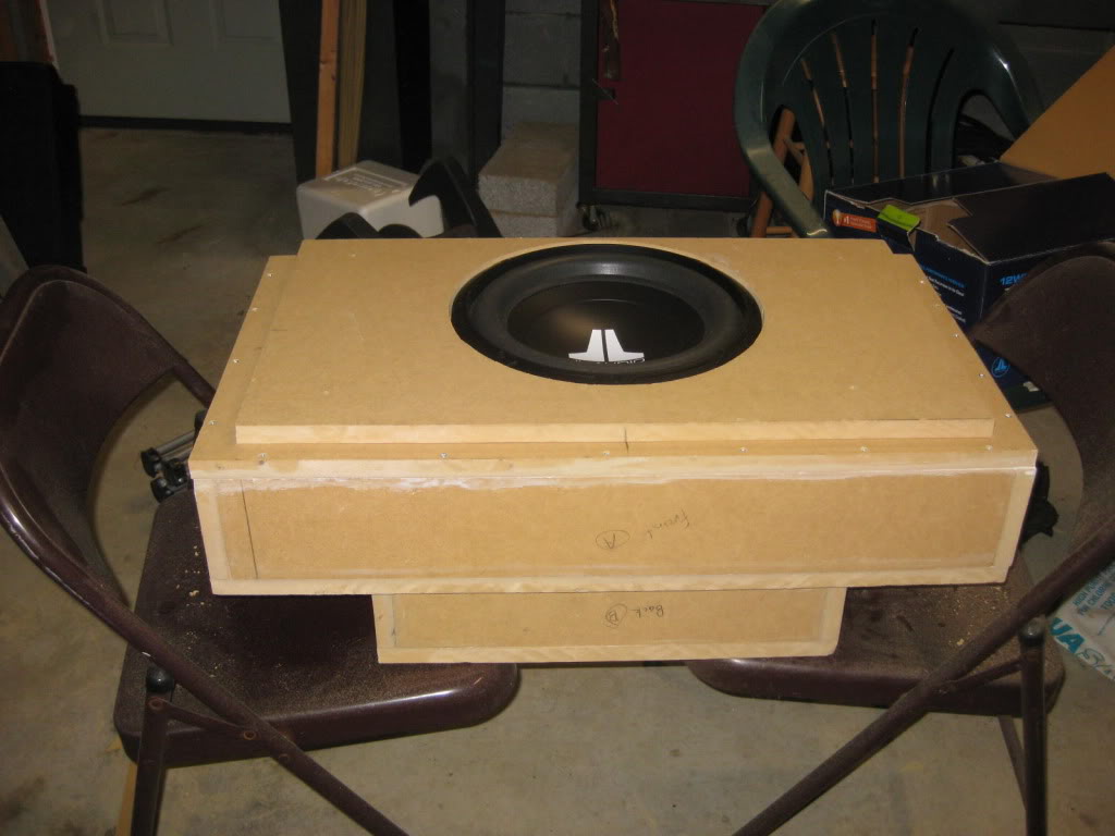

All but finished.
Video:
In a bit.........

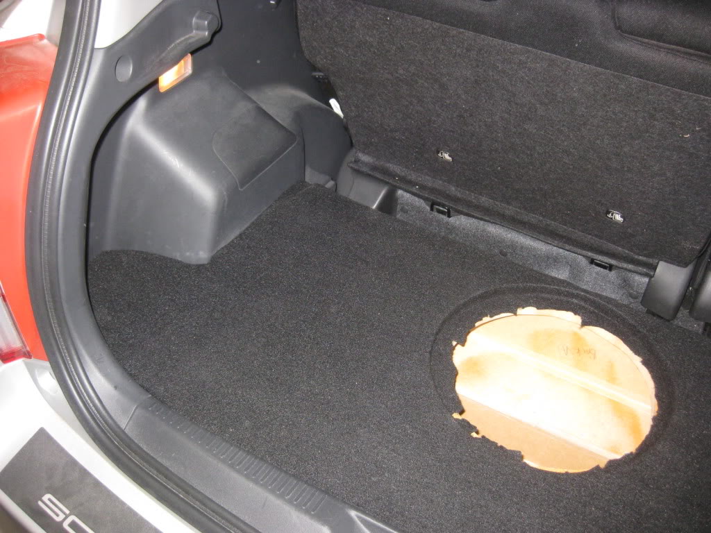

Ready for trim panels:
Other side ready:
Forgot to take a pic of trim panels with no carpet but anyhow, with carpet:

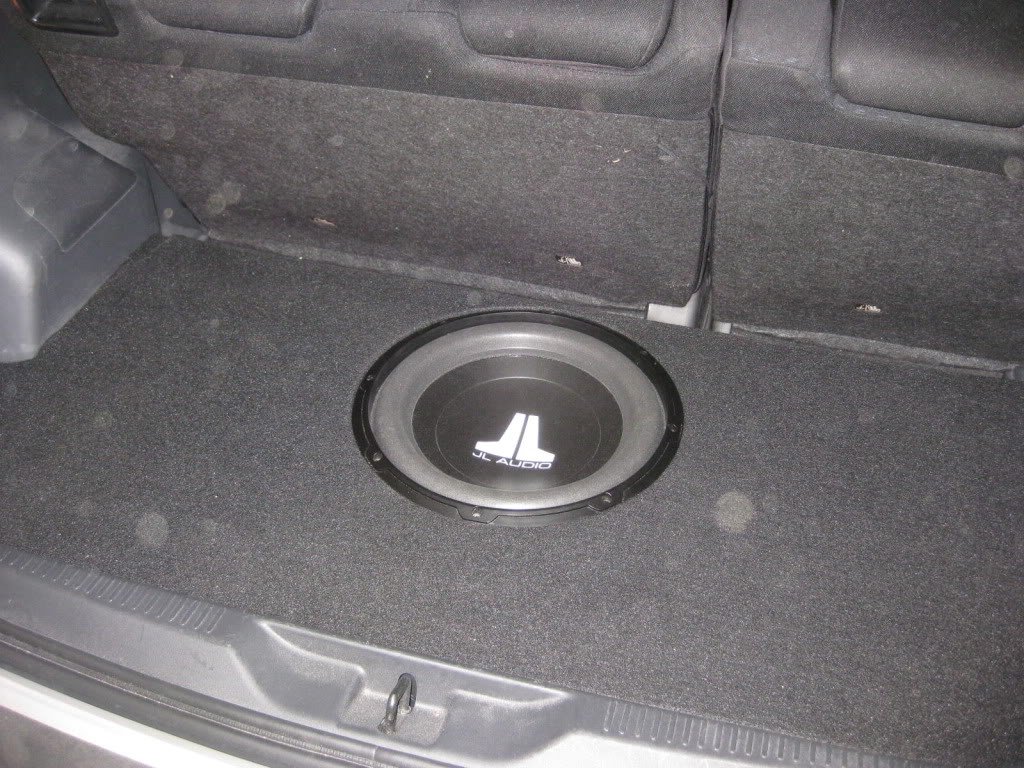

With the sub installed:
Another view:
