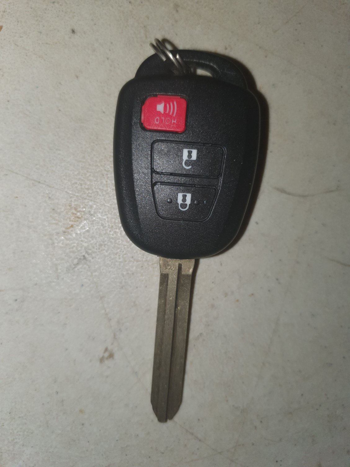

I am having the worst trouble trying to program my car key. I am finding the directions online which are below.
My car enters in programing because the lock cycles, but I am unable to add the new key.
My new key is a MOZB52TH key just like the factory one I own. This is the key I bought:
My key is a MOZB52TH key, factory key came with the car
In the Facebook group other people are are saying they have a MOZB41TG. But I found out every one of them has a Scion built before 2012.
So I'm sure we have different keys.
I just can't get this programmed to my 2013 Scion xD.
Thanks for anyone who can help.

UPDATE: Figured it out
ok I solved it and here's how.
We 2013-2014 Scion xD use a different key. It is the M0ZB52TH, but not just any key with that FCC ID, it has to be a Scion key that is OEM and yes it will be more money, I got mine for $70 on ebay and it is OEM.
here are the images of it, you can see it is OEM.
I used these instructions:

Originally Posted by Proxy_J
I got to the part where the lock cycled, then it wouldn't work... Probably my stupid Ebay key
yes you are correct, you need to buy an OEM key, google it, they sell them online, even on ebay. do not buy the cheap ones that are not OEM it will not work. I have no idea why but they won't
