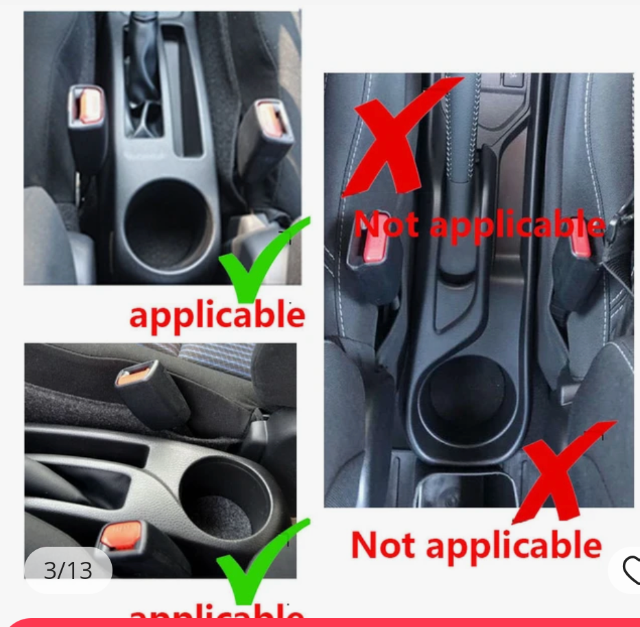

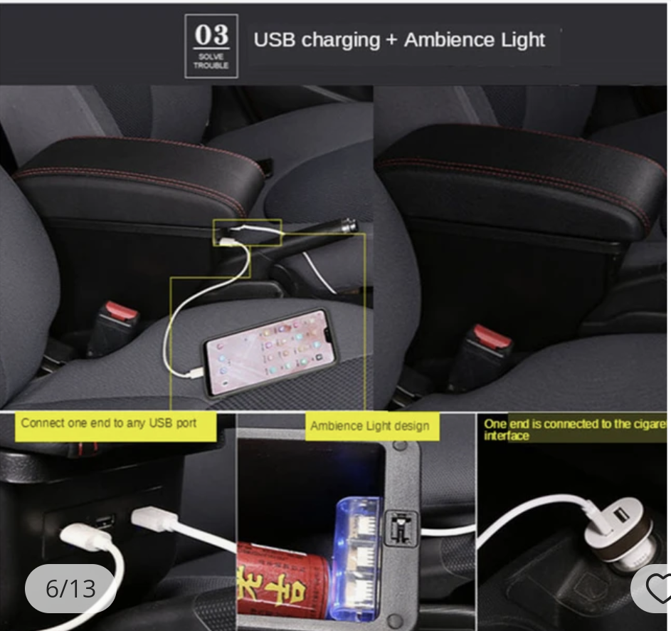

Found this on this site for $93 shipped to the us for anyone interested.
https://en.impex-jp.com/parts/new/se...No=08471-52330
Must create an account first to order.
For anyone else interested in something aftermarket I found one on aliexpress for a Yaris/vita that should fit. Will update on arrival. This was the most sturdy design I could find with the support in the front.
https://m.aliexpress.us/item/2255801...yAdapt=glo2usa
