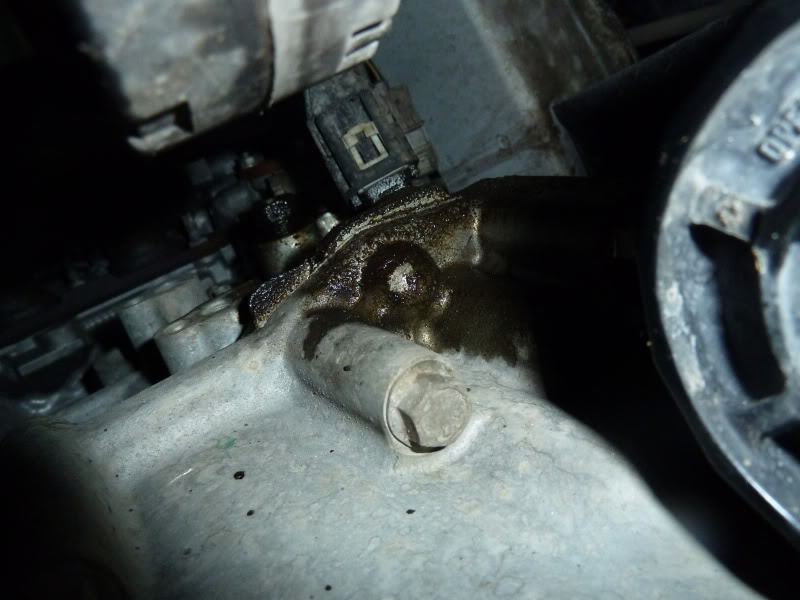

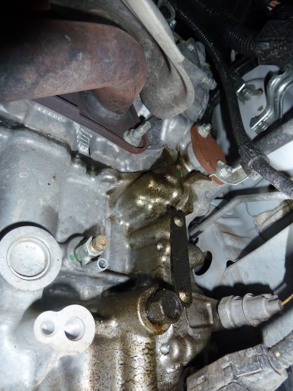

Saw this while changing my oil last week. Looks like oil, coming from up high on the back of the motor.
08 xD 5sp, Mobil 1 5w20, 60k miles

Any body else seen this happen? Or have any idea of what could be leaking?

how many miles you got? it's where the valve cover meets the timing cover... i had the same issue.. but mine was fixed by the dealer under warranty.
60k, My factory warranty is up, but it purchased the extended warranty up to 100k so hopefully it covers this...
What did they have to fix/replace?

had to pull the valve cover and timing cover to replace both seals
You got it, I have the same problem. Fidelity is sending a rep out to inspect before they pay to cover it. Otherwise it is going to be a $900 repair. Not what I expected from one of the cars rated "most reliable."
