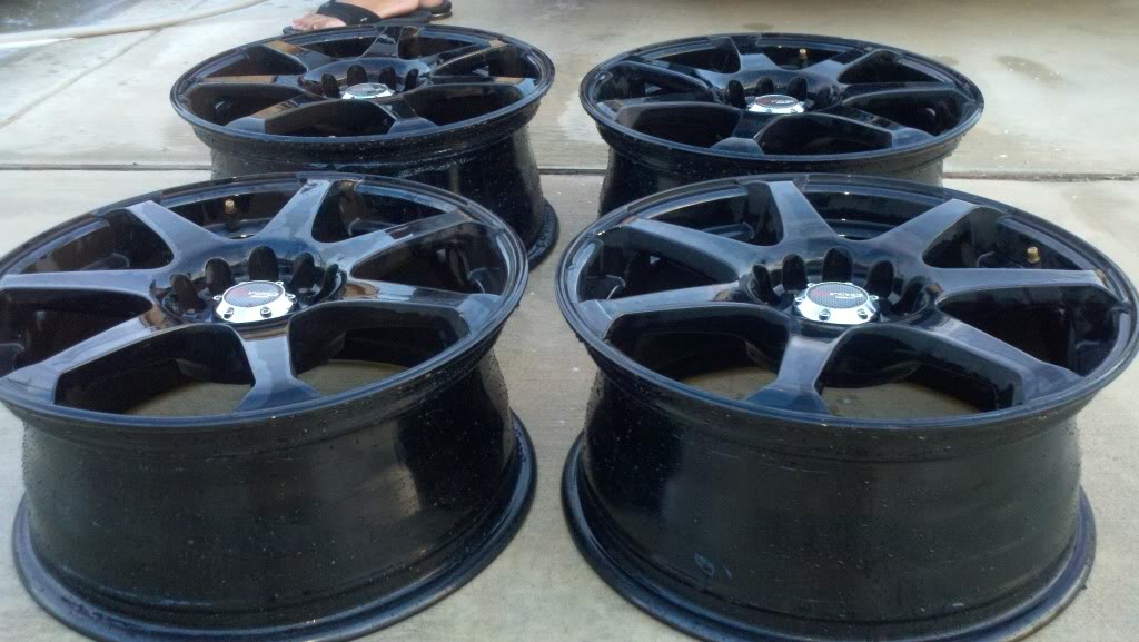

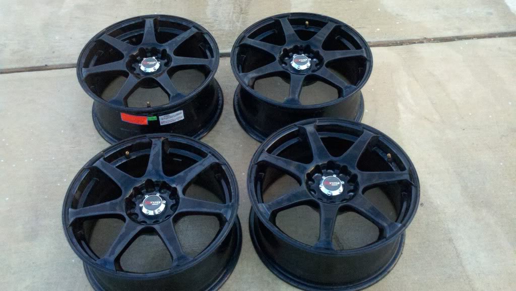

okay so i have a 2012 scion Xd and was wondering if my wheels would fit this car... i have drag dr-33 16x7 5-110 and i wanna say the offset is +40. so would i be able to use these at all?

The XD bolt pattern is 5x100. Everything else looked ok though.

the factory offset is +38, so other than the bolt pattern, you're good.

you can do a search online and see if they make adapters for them, but that's really all i can think of. you will need to look for a 5x100 to 5x110 adapter. happy hunting.
