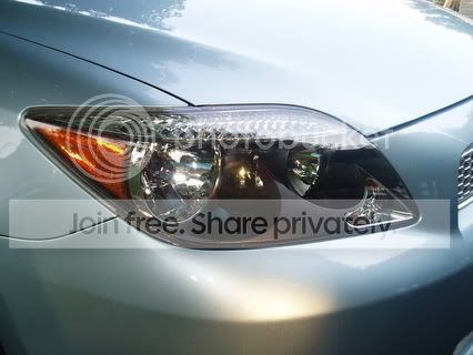

Old Jun 8, 2005 | 11:04 PM
sciongirl81's Avatar
Posts: 773
From: NJ
here are pics of mine "installed."
Old Jun 8, 2005 | 11:49 PM
RockBlocker's Avatar
Posts: 4,295
From: Ride21
Nice job

Old Jun 11, 2005 | 12:42 AM
purpled_out_tC's Avatar
Posts: 4,150
You can't post photos from your computer you must host them first
Try this link for some help https://www.scionlife.com/forums/viewtopic.php?t=60323
There's mine. I used alcohol to clean the lights. I'll take better pics at a later date. The install took me about 45 min. Very easy and highly recommended.
I know the mask is not favored, but in this world of SUVs, Trucks (especially the ones with big tires and no flaps) and Big Rigs everywhere it's staying.
Oh and yeah, yeah I know I should of used a tripod. Don't have one, but I'll get one at some point in my life. Thank you though.

okay so my pics aren't posting, and it won't let me edit. But the links for photo bucket work.
