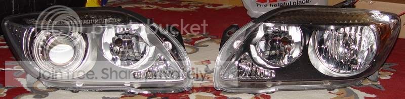

i updated the original post with couple pictures of the lights on the car. i'm late for work so i'll have more pics later.
here's a 'before and after' picture
