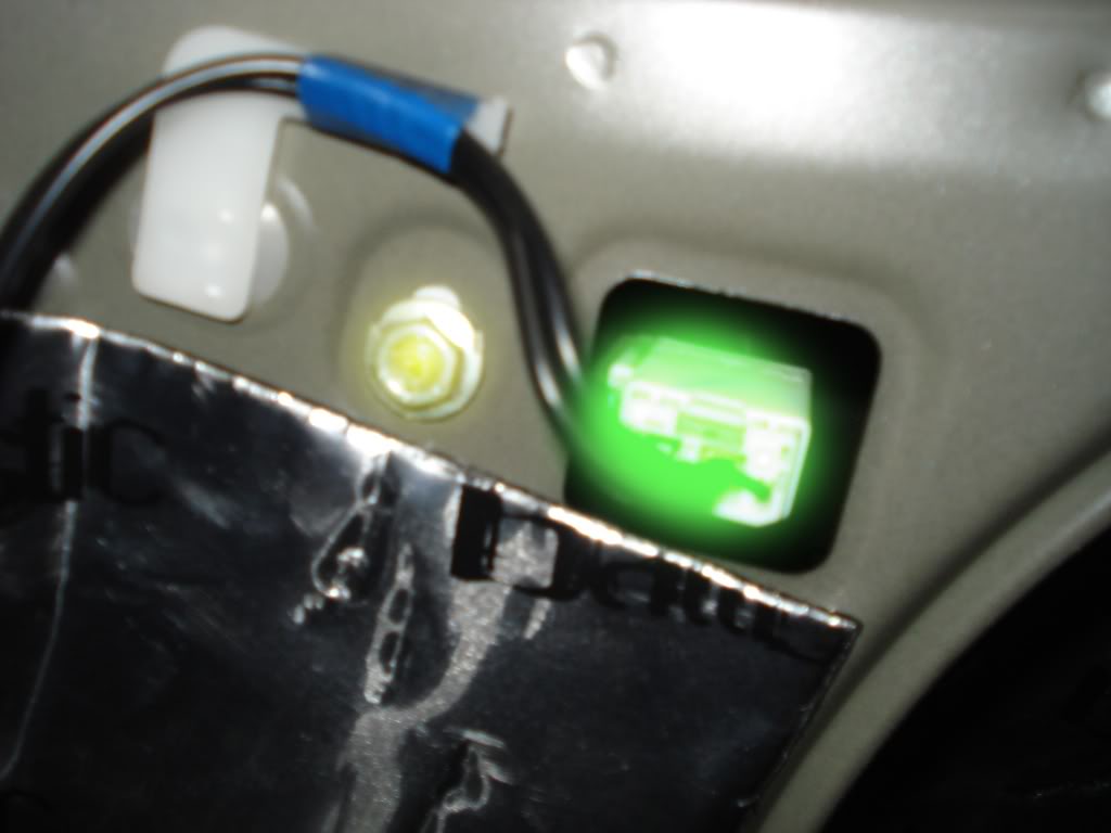

Go inside of the trunk to where you removed the paneling, use the wrench and 10mm socket to remove the highlighted bolt.(Yellow) Also remove the wire cables that are connected to the right of bolt.(Green)

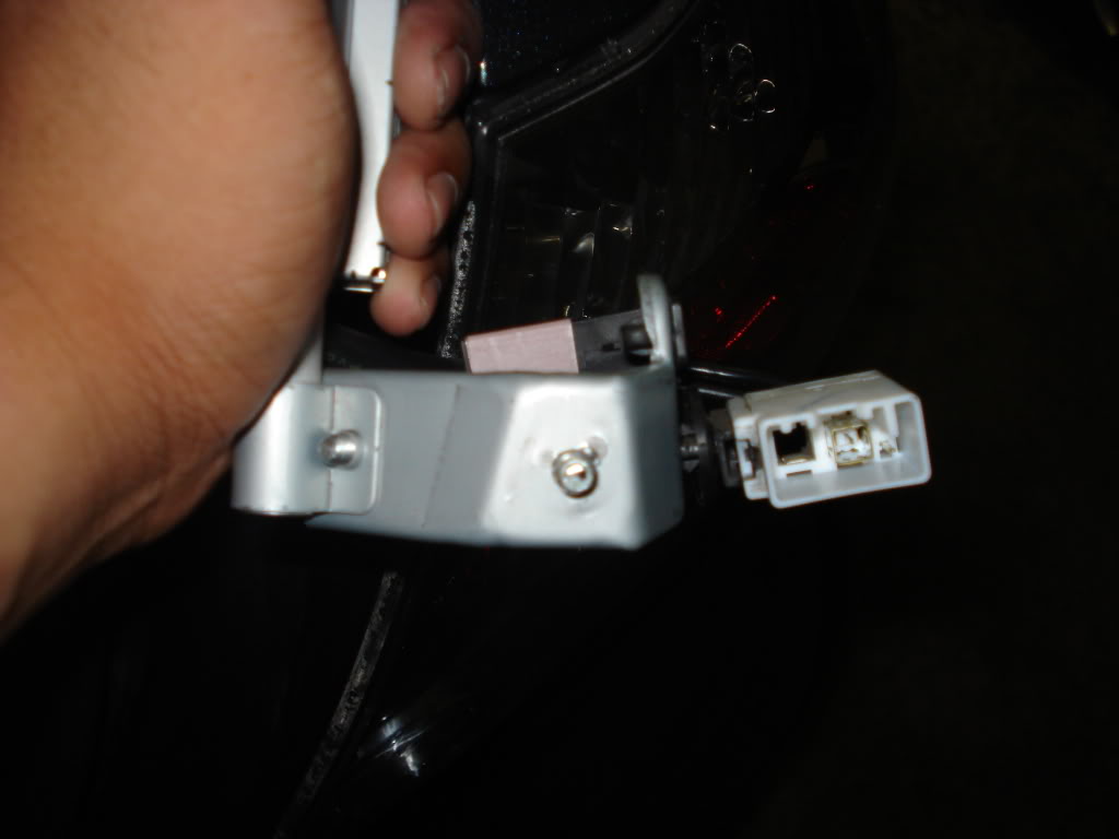

Take the antenna, and take the wire plug and switch it backwards so that it looks like this.
Then put it back in at an angle facing the taillight but angled more down. Like so. Then just rebolt it in. and you are done. Put the interior pieces back in and you have a hidden antenna. I have the same reception as I did when I first got the car. Hope this was helpful.
