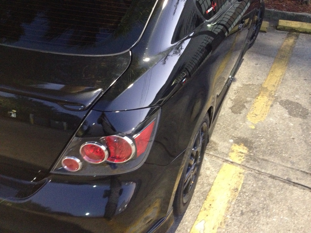

I bought a plug a while ago but never got around to doing the mod until now... Still didn't use the plug though lol

@ xBATMANx: did you use body filler also?
Old Feb 6, 2013 | 08:15 PM
  #58
x_Batman_x's Avatar
Posts: 2,111
From: New Orleans
Yup
