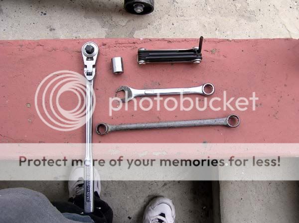

tools i use is

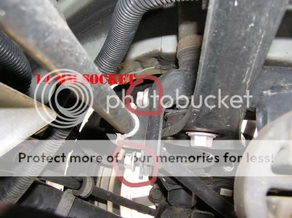

14mm socket and
two 14mm Ratchet Wrench.
hex key tool ( 3/16)

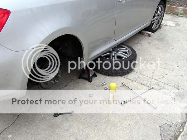

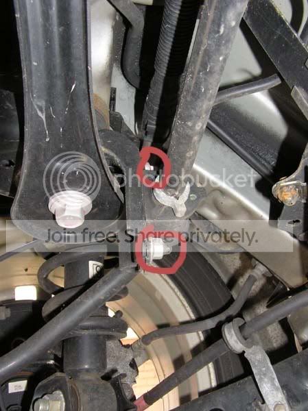

Jack up the car with Hand brake on. I removed the rear passenger's tire. it made it easy to slide the sway bar out.
Now remove the those 4 bolts from under the car.

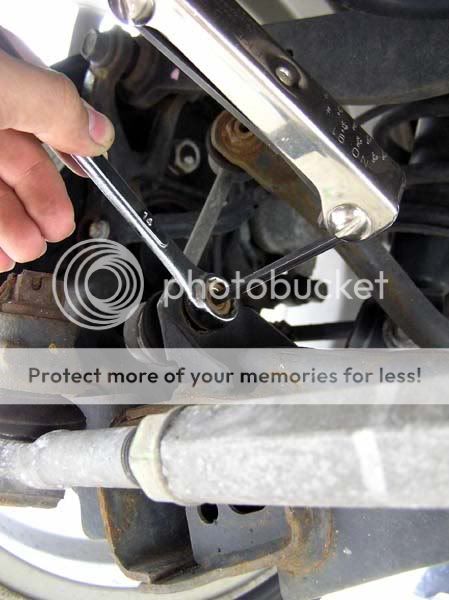

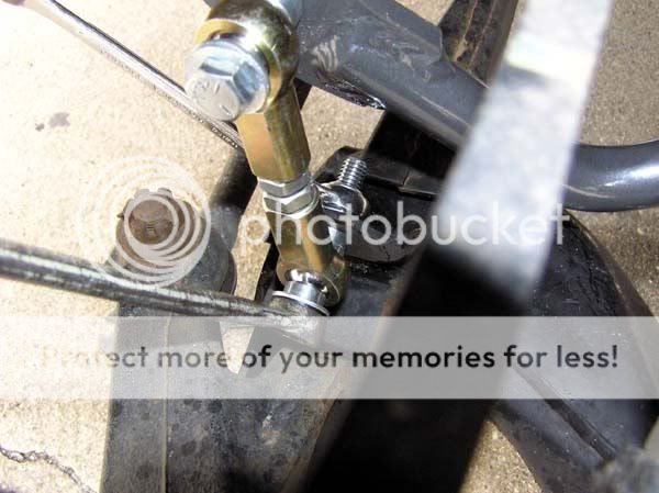

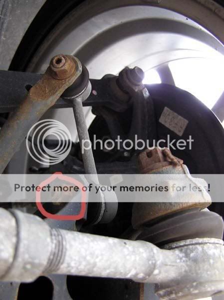

now removing the Endlinks, just the lower nut needs to be remove, You can leave the nut connected to sway bar alone
You need the Hex Key to keep it from turning while removing this nut.
Now slide the bar toward the passenage side where the wheel was removed.

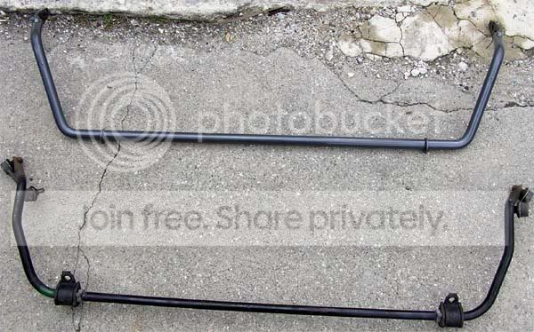

Comparing the Progress Bar and the stock bar. Progress Bar weight almost twice as the stock bar.
Now slide the new bar in.

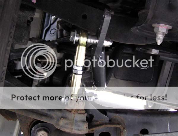

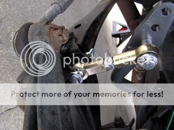

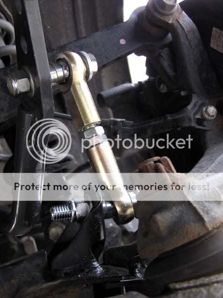

I use the two Ratchet Wrenches to tight the new endlinks.

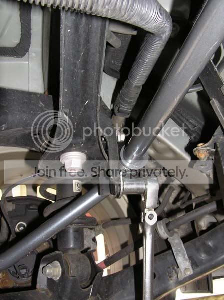

Passenger side rear view
Driver side rear view
I used the inner hole for firmest setting.
Recheck and re_tighten everything.
