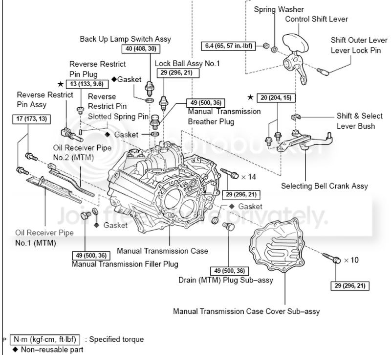

Anyone know if the filler and drain plug gaskets are the same as the engine oil drain plug gasket?
Old Dec 21, 2006 | 01:46 AM
  #178
Fredzy's Avatar
Posts: 30
From: Pittsburgh, PA
The transmission fill and drain plug gaskets are much lager than the engine oil drain plug gasket.
Old Dec 21, 2006 | 04:06 AM
  #179
SquallLHeart's Avatar
Posts: 15,699
^^ 24mm.. pretty big.
