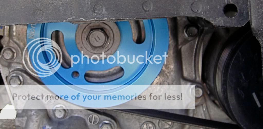

Got mine on! Very nice - I'm liking it. As for feel, I don't notice a huge difference in acceleration or low-end "pull", but there might be some there. I didn't quantify anything before/after. I DO notice less engine braking - i.e. when I leave the car in gear and take my foot off the gas, it coasts smoother and farther. It also seems to shift a little easier - well, not "shift" per se, but the engine seems to re-engage more smoothly as I release the clutch. Does that make sense? A little hard to describe. Between that and the NST SS bushings, though, shifting overall feels a lot nicer than it did new! :D
Overall, installation went quite easily. The pulley came off with my electric impact (el cheapo, rated at 240 ft-lbs). It had to hammer for a few seconds, but then it spun right off. I used a deep imact socket, which fit under the wheel well just fine. I would recommend one of these - I definitely couldn't have gotten a secure bite on the bolt with a standard (shallow) socket. To put the bolt back on, I just let the impact hammer a "few" times - my torque wrench just spun the pulley.
Other thoughts on installation -
1. The black plastic splash guards are annoying. If you have a socket adapter for your cordless drill, I highly recommend dropping a 10mm socket on there - much quicker than turning those little bolts by hand.
2. Moving the alternator BACK to loosen the belt was probably the hardest part for me. When I loosened the tensioning bolt, the bolt just came out - it didn't actually push the alt back. So I ended up tapping it back bit by bit with a dead-blow mallet - minor PITA. Re-tightening the belt was no problem - tightening the tension bolt with a ratchet snugged it up just fine. Don't forget the second bolt - just under the long tensioning one.
3. Removing the stock pulley (after I had the bolt out) was a little tougher than I thought - it didn't just slide right off. I had to wiggle it little bits at a time, and get it at just the right angle, and it eventually came off by hand.
4. Getting the new one on wasn't too bad - carefully line up the keyway slot, start it by hand, and tap it on gently with a dead-blow mallet. This seated it just fine, and then it was just a matter of re-assembling everything.
Thanks to NST for a great accessory to give me a smoother, more efficient car! Looking forward to watching the mileage! (I'm already considering doing this on my Vibe... )

I installed my pulley this weekend. Very smooth install as well. My only concern is the torque on the pulley bolt. Once I got it to a certain torque the pulley would spin and there is no easy way of holding the pulley stationery to get a good torque on it. I am keeping my fingers crossed that I got it tight enough. Great product and great DIY thread. Thanks!

Well the install seems pretty easy, but I cannot get the crank bolt off. I borrowed my brothers electric impact gun that he uses at his body shop. I dont know what its rated for but he said it was $150 so I thought it would be up to the challange. I guess I gotta wait another week to get this thing on.

not sure if this will help, but make sure if your impact isn't above the 300ft lb. area to not use an extension when trying to remove the bolt, thats what worked for me. you'll need a deepwell to get on the bolt, just keep trying, may come off after a few tries.

as cobaltbravo said, you are going to want a STRONG impact wrench. my 250lb wouldnt budge it, had to switch to the 550lb, which took a few tries. this was a pneumatic type. also make sure you are not using an extension, it will take the "impact" out of the impact gun. as stated, you will probably have to use a deep socket if the wheel well is getting in the way.

I just looked the impact gun up online, its only rated for 150 ftlbs so there is my problem. I wont even bother trying it again today and will just wait for the weekend.
