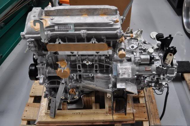

DESCENDANT / WORLD Racing Scion 6-speed tC1 swap kit will be designed for 2005-2010 Scion tC1 owners that wish to convert there current 5 speed tC1's to a 6 speed using the new tC2 transmission.
The DESCENDANT / WORLD Racing 6-speed tC1 swap kit is in it's 1st stage of development but we expect to have it driving / testing with in the next couple weeks. I can currently tell you it will include a custom fly-wheel & motor mount which we are currently machining for installation. Once I have more details I will post them here for everyone to know...for now enjoy some pictures of the 2AZFE Scion tC1 engine with a tC2 6 Speed Gear box bolted up too it!

so cool that the 6speed bolts right up to the 2az. I assume the starter either sits higher from center or lower from center than the 5speed? does the 6speed use the same reverse sensor as the 5speed? are the clutch disks and pressure plates interchangable?
