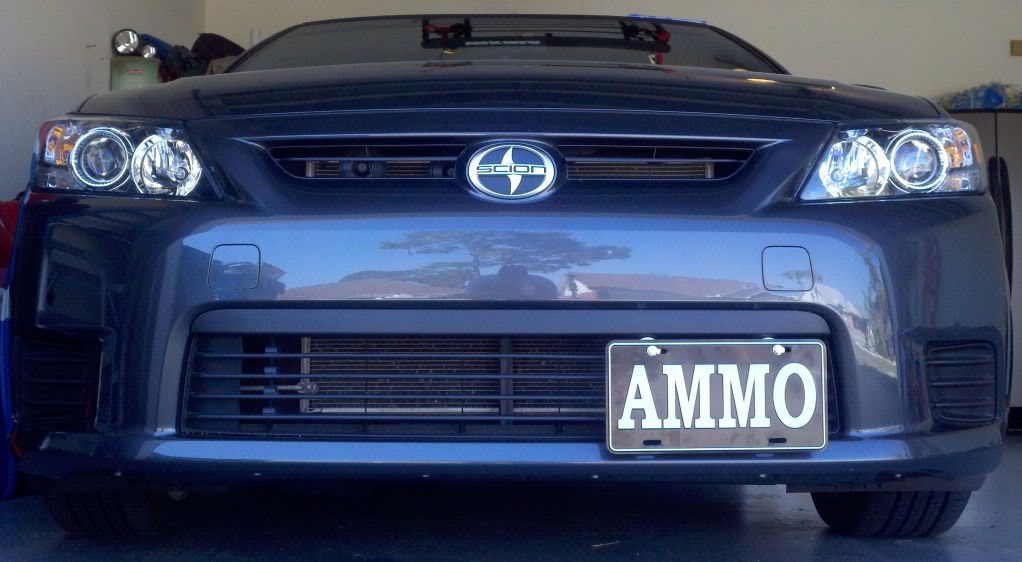

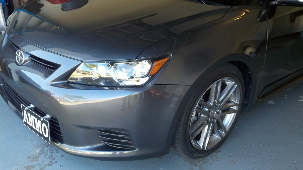

Got a front license plate mount kit this week. Moving from Florida to Texas, I'm going to have to get a front plate, so I wanted to test out some options before having to permanently attach a plate. I spent $36 and picked up a set from Cliff, who sells some stuff on here. If you decide you want to check out his product, here's the link to the thread https://www.scionlife.com/forums/show...96#post3613196
Pros: Biggest advantage is these are pretty much universal and attach just about anywhere on your grille. They're easy to install and provide a clean look.
Cons: Only real complaint is that I had to remove a dozen screws from the air dam underneath the car to get to the back side of the grille so I could affix the rear washer and nut.
Review: Cliff (bbszero) sells aluminum front plate holders for $36, including shipping. He hadn't sold any to tC2 owners, so after providing him some measurements, he sent me the size to best fit the new tC. He was very responsive and had the parts shipped within a day. The brackets themselves are sturdy, well built and brilliant in their simplicity. The mounts have a bolt in the rear that goes through the grille and attaches to a large washer, lock washer and nut.
The installation options are nearly limitless. It took about 5 min to remove the air dam under the car, about a min to install the brackets and probably 40 min adjusting them around to exactly where I wanted them. Up one row, over a little, attach to the top of the plate, attach to the bottom. I felt like my wife when she can't decide what to wear to an event. Even now, I'm not sure I'm going to leave my plate where it's at.
Anyway, I love the PTuning tow-hook mount, but with the additional mounting options and costing 1/2 the price, I'm glad I went this route.

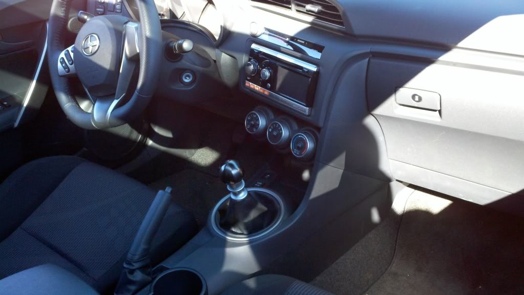

TWM sent me the weighted shift **** I ordered with the short shifter and cable bushings. It's arrival and subsequent installation managed to be the most exciting and most frustrating part of the day. The **** itself is beautiful in the gun metal gray. It's solid and classy. Holding it with the stock **** it reminds me of the difference between the cheap Happy Meal toys and the old, solid steel, Tonka Trucks.
It was to my dismay to realize the **** (which I later found out from TWM) was designed specifically to fit on the short shifter and doesn't work with the stock Reverse Lock.
A dollar for some rubber spacers and a scrounged lock washer and I was able to make it work, but it required raising the overall height of the shifter about 3/4 inch, thus increasing the throw. The extra weight made the shifts feel great, but I couldn't take the extra travel, so I went back to my OEM "Happy Meal Toy" ****.
[sigh] Shiny, new toy and I'm not playing with it. Here are some pictures I took of the **** before I took it off.

hey MightyP that shiftknob looks really good! Do you mind taking a more zoomed out picture including the dash/steering wheel with the shift ****? I'm really debating between Satin and Gun Metal and I'm not too sure which one to go with.
Old Mar 1, 2011 | 09:26 PM
MightyP's Avatar
Joined: Nov 2010
Posts: 2,231
From: Minnesota
As requested... Too bad the way I have it installed for the pictures isn't functional.

thanks a ton mightyP! I think I'm gonna opt for the gun metal instead of the satin. I originally didn't think it would fit in well with the scion interior so I was gonna go for the plain satin finish, but gun metal looks pretty good

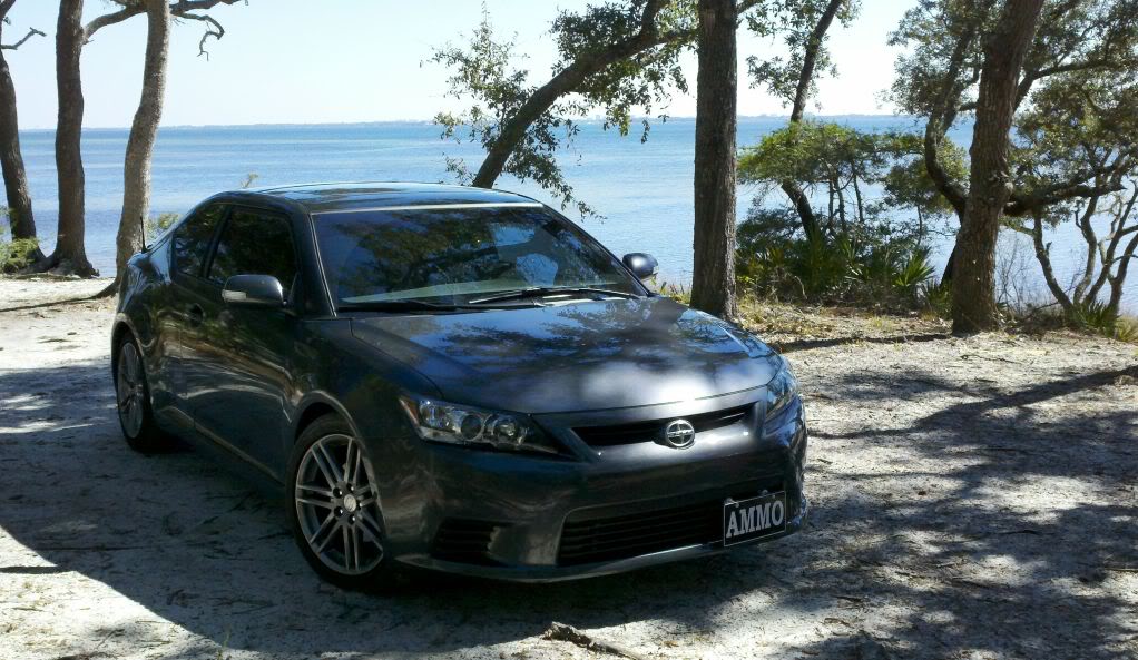

Few more pictures of a dirty car...

Old Mar 2, 2011 | 02:15 AM
XerotC's Avatar
Posts: 361

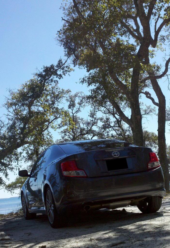

hey mightlyp could you also take some back shots in those gorgeous locations? all the metallic greys i see online always have the spoiler
Old Mar 2, 2011 | 02:59 AM
MightyP's Avatar
Joined: Nov 2010
Posts: 2,231
From: Minnesota
Here's what I have from today. I don't post them (and usually delete them) because I just can't seem to make shots from the rear look right. I'm open to suggestions on any of my pictures, but especially on rear shots.
