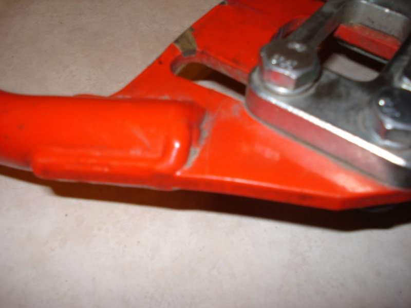

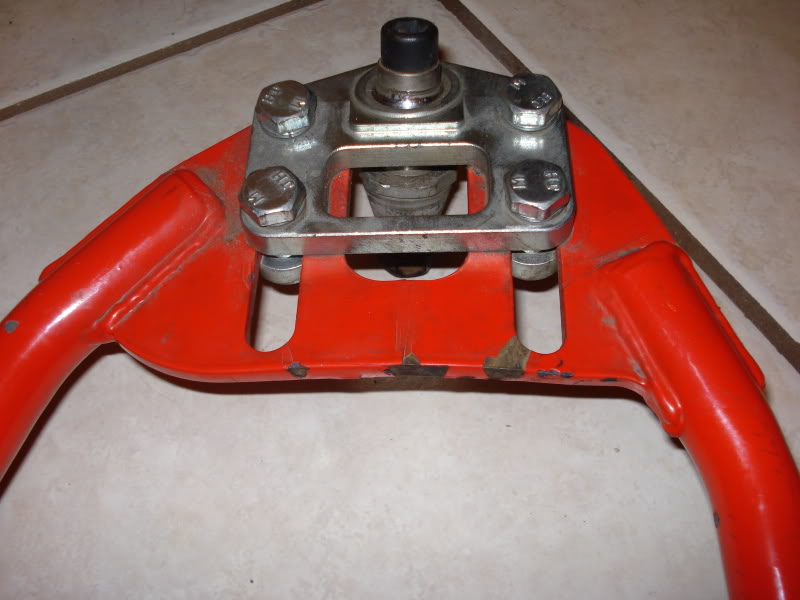

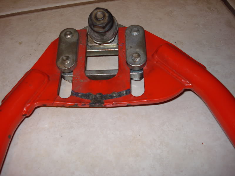

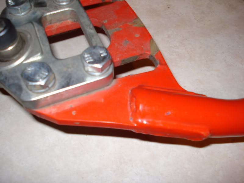

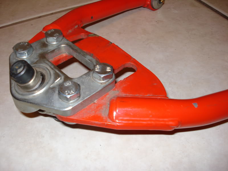

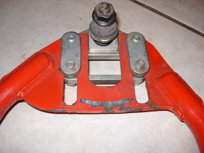

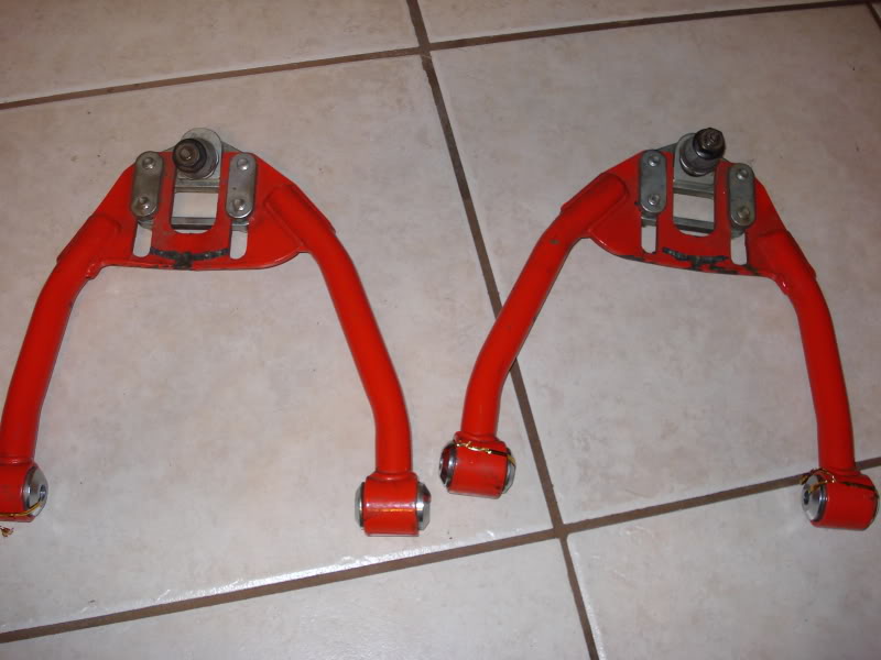

The Pictures:
You can see all the spots in the arm that bent by looking at the powder coating that is cracked at each bend.

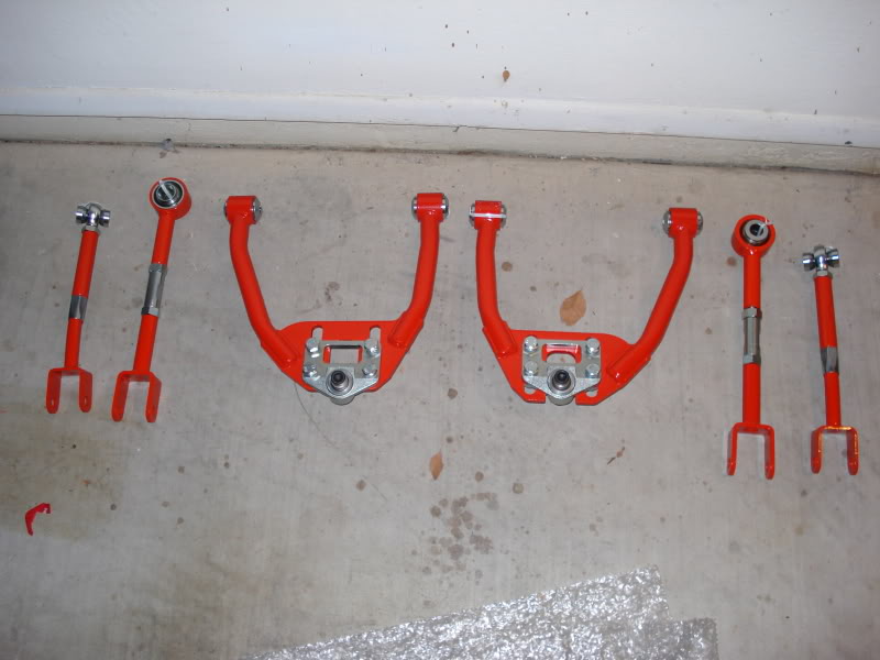

Picture of the arms before I installed them so you can see that I did in fact purchase them brand new and never installed.
Here are the pictures of the bent cheap quality arms
Looks like they failed do to another part of the suspension (looks like the end of a bolt) putting pressure on the control arm where its not supposed to be. I noticed the arc shaped gouges/impact marks on the same side on both arms. Looks like it repeatedly slammed/scrapped the arm causing it to bend/cup prematurely. Since no other powdercoating is coming off the rest of the part I'd say the repeated impact caused it to flake off as well.

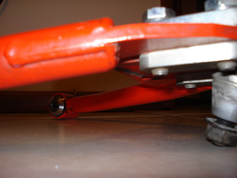

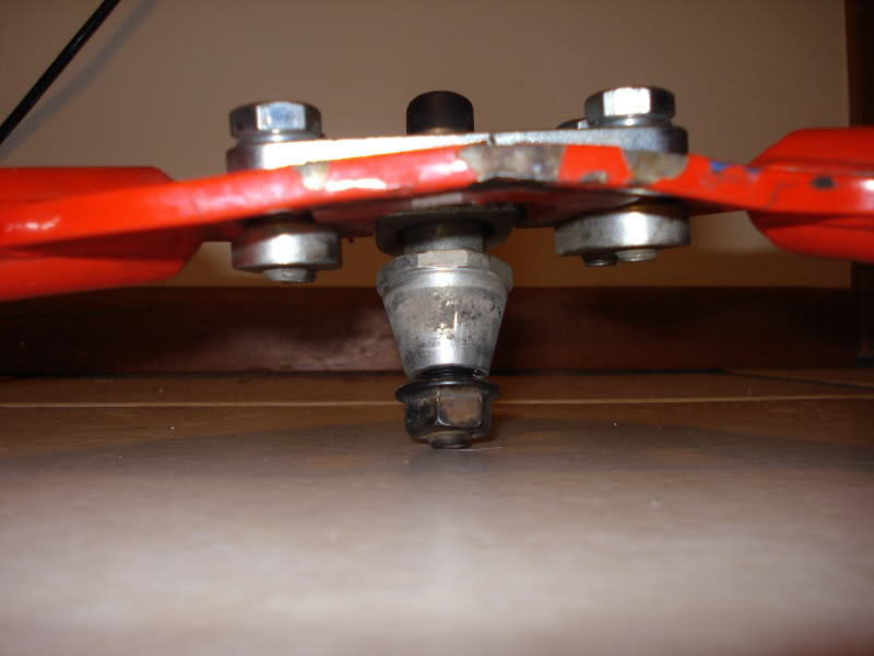

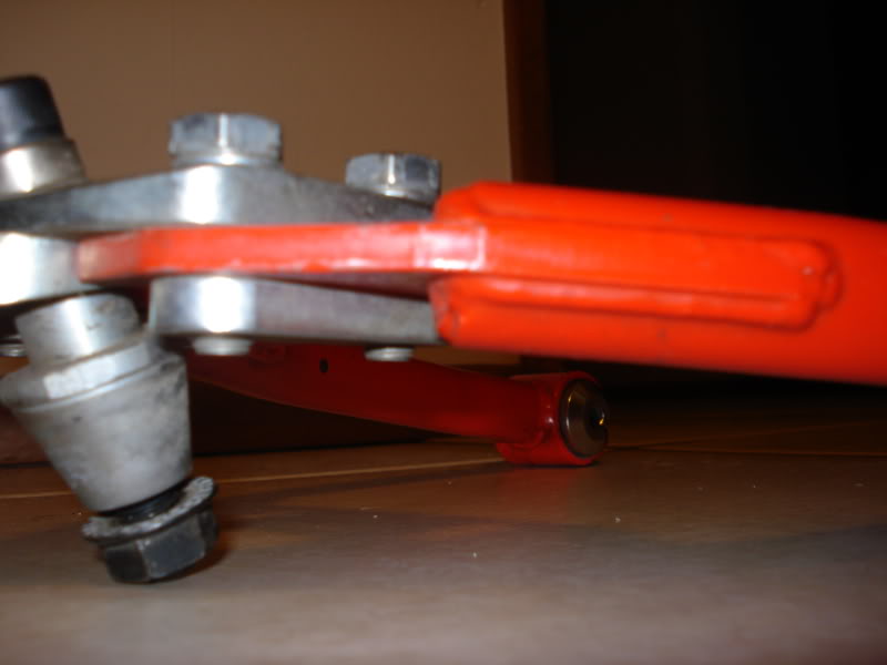

Let me start by introducing myself, I'm Branden, and I'm a sales rep at Ksport USA.
First...our warranty IS NOT transferrable. These control arms were given to a friend of Nicks and purchased off him by Alex. Without a receipt there is no warranty. Warranty's are possible because of the profits from the initial sale. This is basic business practices, try to go get your Sony TV warrantied without your purchase receipt or warranty card and see what happens.
Alex has come to us twice with this problem. The first time he came in he gave us some information that he somehow failed to mention in his post.
With that in mind, the following pics will tell the other side of the story, as there is obviously always two sides to every story.
In this pic you can clearly see where the upright off of the spindle has contacted the control arm. As Alex had told us, he was on a set of lowering springs at a drift event prior to installing our coil overs and had a large amount of body roll. The first time he brought his car to us, we put it up on the lift and found that the excessive body roll caused this contact.
Heres a shot of the upright where it made contact with the control arm.
Side shot
Car on the lift with the suspension unloaded showing the relation of the two parts.
The amount of force that'd be applied at that point during contact is enough to bend ANY manufacturers arms.
It wasn't chipped off, it was rubbed off by your upright. See the pics above
With that logic we would never warranty any new problem brought up to us because there is a first time for any type of issue, product defect or not. The reason for not warrantying the arm is NOT because we haven't seen it before. It wasn't a defective product, it was a improper suspension set up previously installed on the car. Which is a moot point anyway as you didn't have a warranty to begin with.
Suspension arms are meant to articulate only so far. Regardless of whether or not it was designed for a lowered vehicle, if it articulates too much, it'll make contact, either with the body or the upright.

These don't need to be used with our coilovers at all. The set up on his car previously allowed for too much body roll. So much so, that it allowed the upright and A-arm to come in contact when he was doing a drift event. There are a couple key factors that lead to them making contact and bending.
1) The excessive body roll
2) Initial ride height
3) Inadequate damper/spring combo
4) The camber setting on the A-arm adjusted all the way out causing the upright and A-arm to over lap

judging from the pictures alone these products look like fail to me, the amount of material holding the arms to the adjustment plates are far to thin.
when you look at it in all of these pics posted you can clearly see that a maximum (added together) of an inch of metal of obviously sub par metal is all that is holding the car up?
i have seen oem parts go through hell. lowered or not and have yet to see this kind of terrible construction.
i kind of figure that being such an important suspension piece, something else should have broken/bent before this ever did.
i call quality shenanigans!!!!
Not necessarily, I'd say to keep this kind of thing from happening you should always check for clearance as well as maintain the components already installed on the car.
meh on ksports defense.
im a 3rd year mech engineer majior.
ive designed 3 sets of suspensions via autocad/solidworks for offroad baja vehicles used in competition. all though the plate appears thin the forces it can handle when the correct and PROPER torques are applied im sure far surpass the quality control.
......just sayinnn
I kinda agree that the product is appear to hold less then i personally would like it to(if it were my vehicle) and less then the "ad" says it will.
I think a replacement set should have been made available, but through an initial conversation.
KSport: Are you saying his dampers were damaged or inadequate? I'm trying to get a better understanding on your "defense".
PS> I don't own any K-Sport products, but have heard only good things about them and I'm considering picking up the coils they make for the xB2. this thread does nothing to diswade me from that thought.
