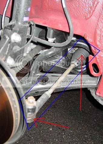

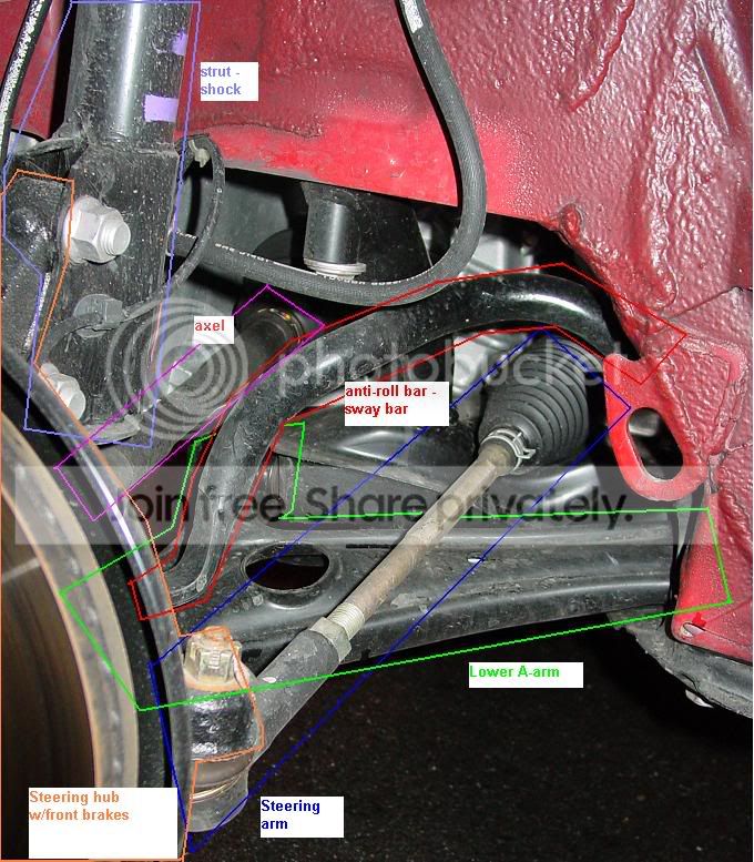

A few weeks ago when I had the front wheels off to change my front brake pads, I took pictures, for reference, of the suspension arms and bolt locations. There currently at my home computer and I won't be able to access them untill I return home from visiting family overseas. I can put arrows in the pictures to show you what I'm talking about..
Here's a basic overview. These are the key components to the xA's front suspension.
What you will probably need to change, (what I've had to change in my other car a few times after hitting things) is the steering arm below. The joints can be dented or damaged under hard impact. Especially the joint I've pointed to in the upper right side of the picture.
The ONLY other piece that may have gotten damaged is the A-arm, but I think it's very unlikely because it's rubber bushings allow for some flexability and give. The steering arm doesn't have this kinda of flexabilty. It's all metal to metal joints.
Good luck.
