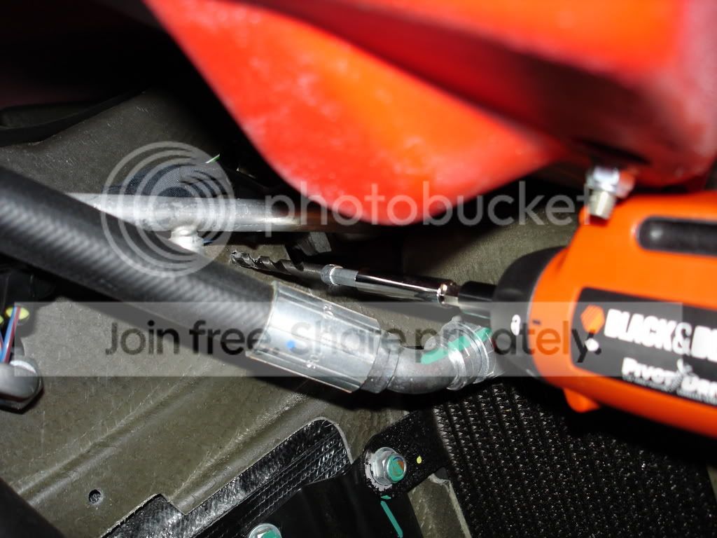

Recently I addressed one of the known issues with '05 through '07 Elise/Exige/Exige S, the lack of HID lights. Lotus puts the $ into the frame, body and suspension. Powertrain and drivetrain is rumored to be pretty cheap as Lotus has a good deal with Toyota on these components. I guess lotus figures you can upgrade the headlights yourself if you like.

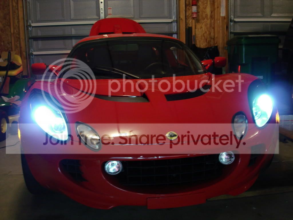

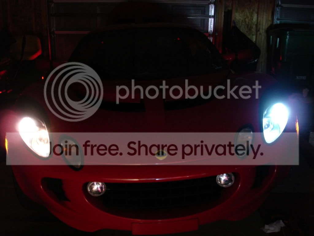

Here's how the stock light (passenger side) compares to the HID I installed.
I had to drill the radiator support component to allow mounting a bracket that will hold the ballast:

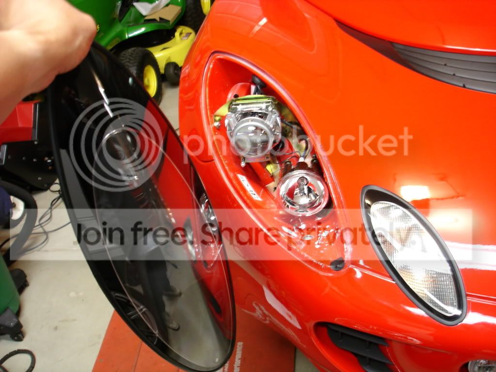

I took the headlight cover off to realign the headlights and take advantage of the added light intensity:

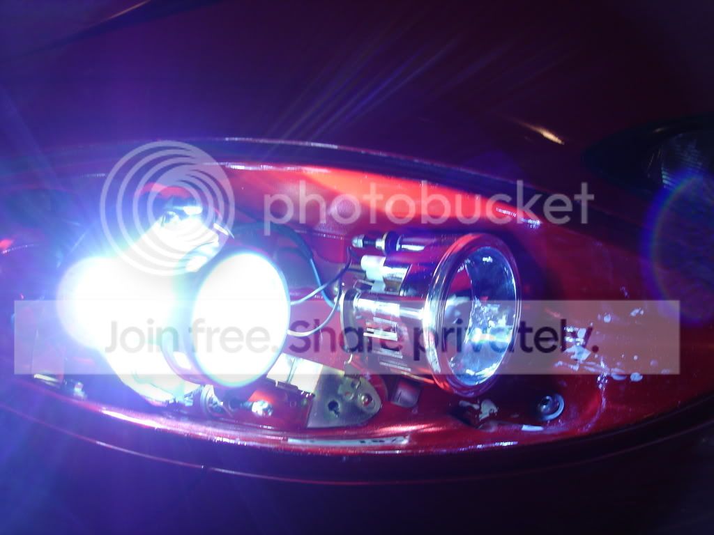

closer look at the HID low beam:

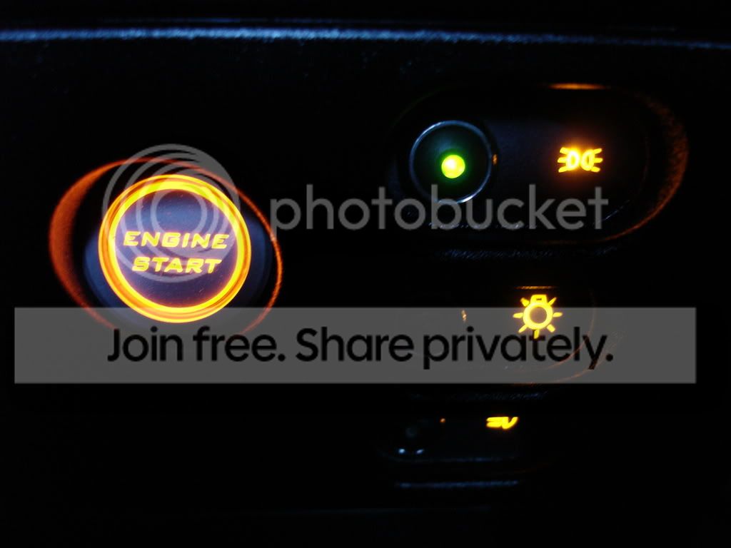

Prior to this I disabled the DRL which activates the low beam whenever the engine is running. This is not good for bulb life if your updating the low beams to HID. This was simple enough. First I took the engine start panel off:
2 screws and the panel comes right off:
Then pull a connector (green wire) apart and the DRL feature is off:
I used these tools to get to the connector:
and pulled the 2 wires apart:

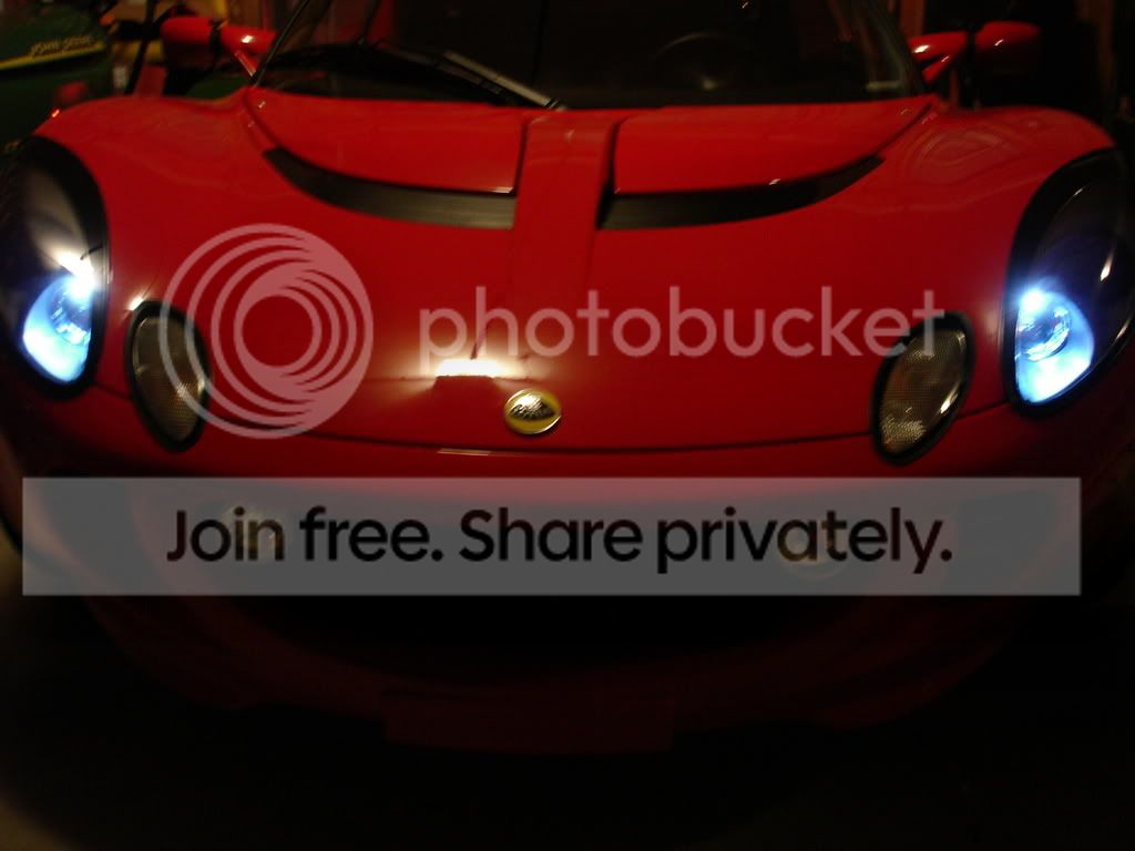

I updated the front parking laps to 5 point wide LEDs so I will always drive with my parking lamps on. The Elise is a pretty small car so this is a safety thing for me to do every time I drive the car. Here's how the car looks now on the front with parking lamps on:
and finally the Finished product:
In real life the lights are not as blue as they appear in these pics. I did not adjust the White Balance in my camera and thats probably why they appear very bluish, in reality they are only very slightly blue.
Outward vision is so much better than stock now. I am glad I upgraded the headlights.
