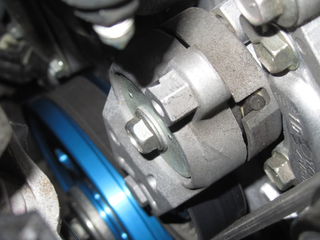

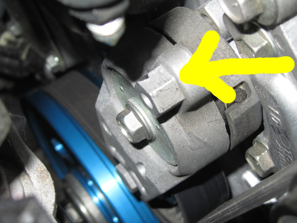

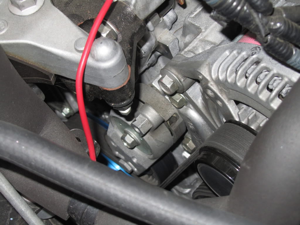

pull towards the front of the car on this to release the tension of the belt using 14mm wrench, u can see it got scuffed a bit

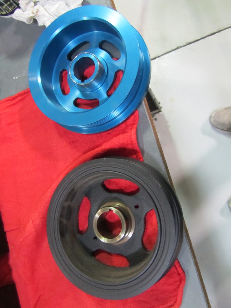

gently get the rust off the ring and oil it on the new pulley
install the pulley, hammer it in with a rubber hammer

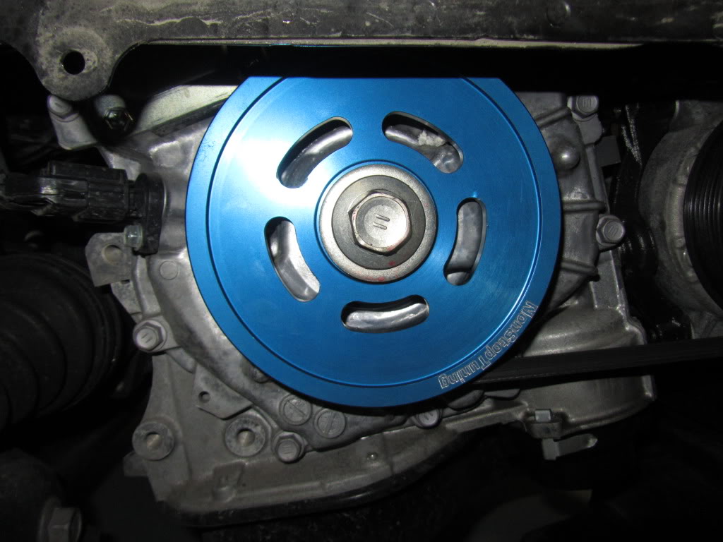

put the belt back on while pulling on the release tension thing
and ur allset
