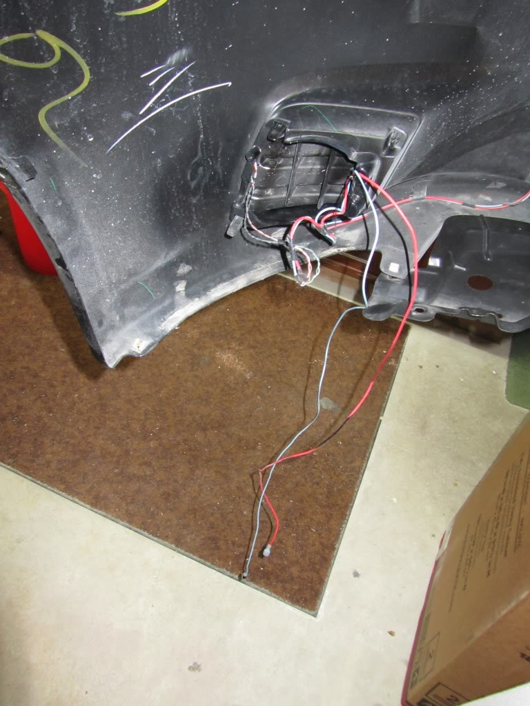

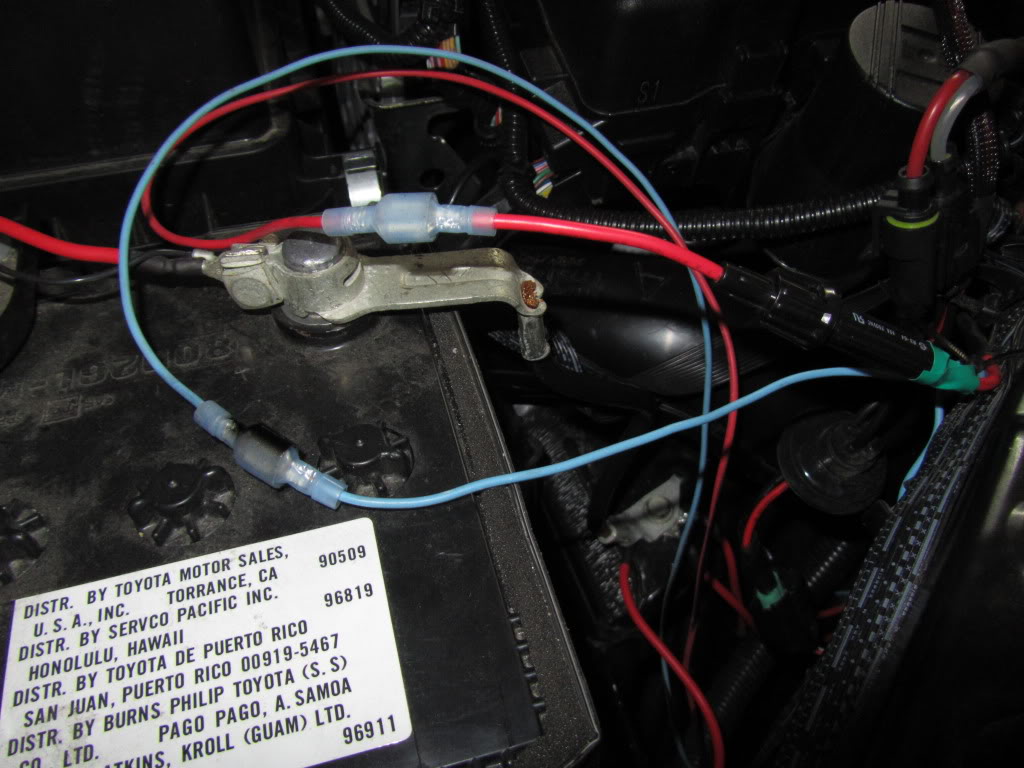

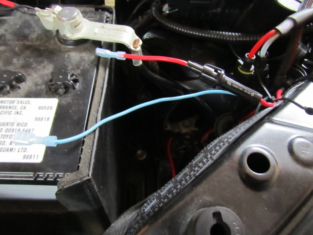

Remove the parking lights and unplug the paking light holder from the power wire.

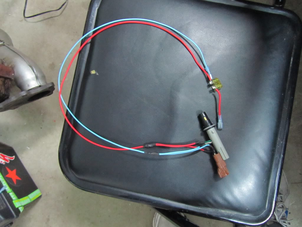

Step 3:
Splice wires into the wires on the holder. Green is POSITIVE and Black and White is GROUND(every black/white wire in the car is the ground!)
Ignore the regular fuse, put the inline fuse holder in that place
Crimp on the connectors
Step 4:
Plug the parking light holder back in, 2 wires are now hangin like this:
Zip tie em

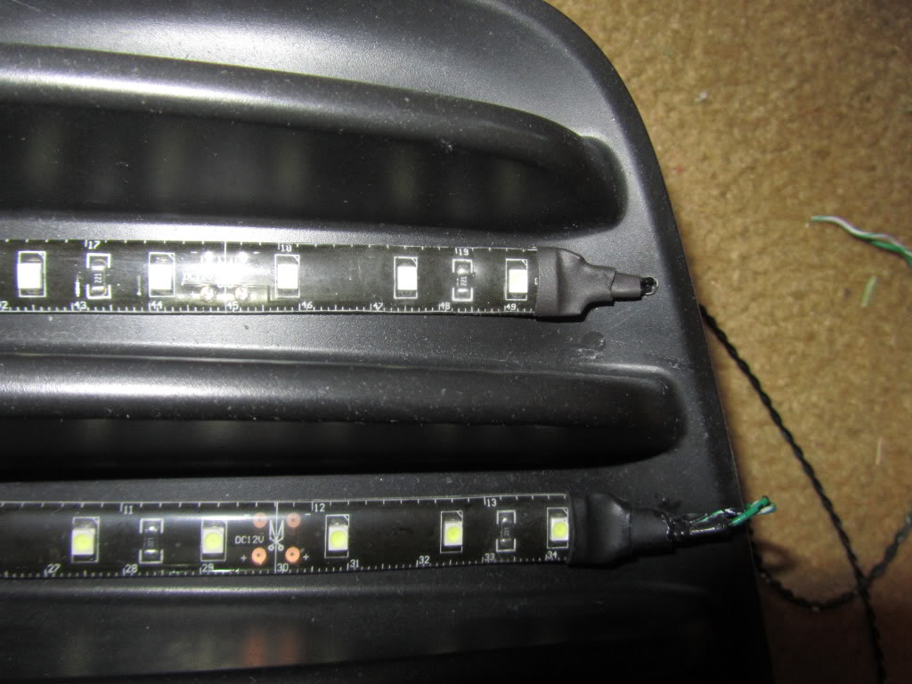

Take off the fog light covers and align the strips inside the middle two gaps
Step 6:

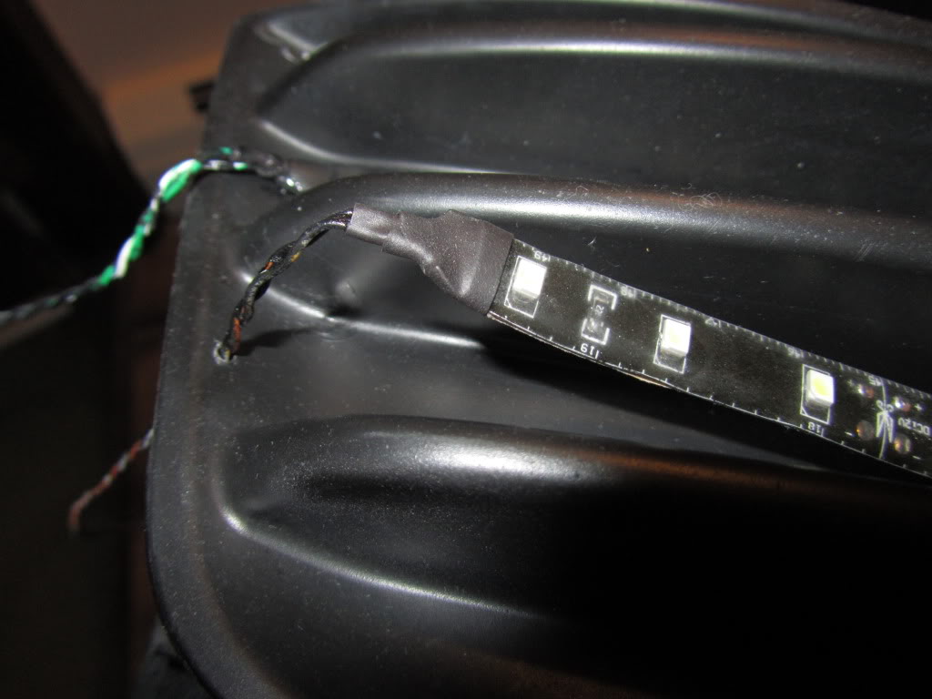

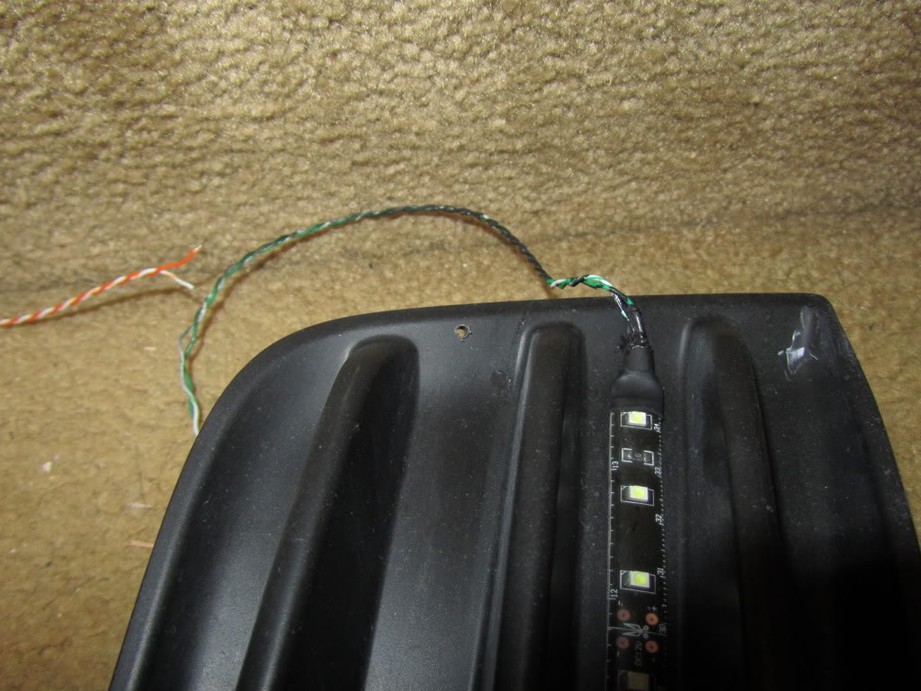

Either just stick em or Drill a hole to feed the wires through. Drilling is much neater cuz over time the paint strips from wires

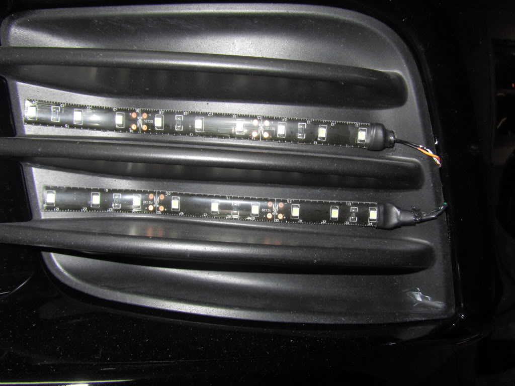

Step 7:
Solid color wires on the strips are POSITIVE, stripped are the ground
Place the fog light covers back in and run wires from the left lights to the right

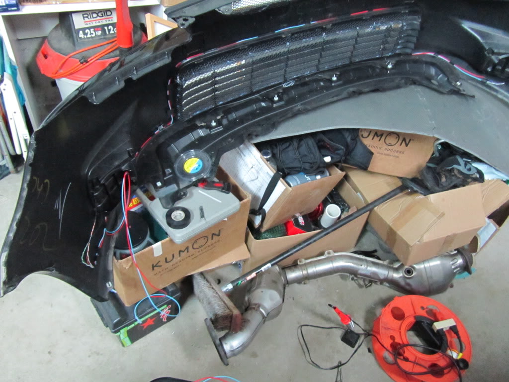

Before you put crimp on connectors, check the lights with a 9V battery to make sure there is no short circuit anywhere
Step 9:
Plug everything and turn on the parking lights
Reinstall the bumper
