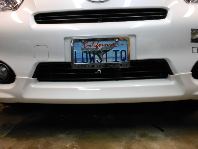

I finally got around to installing the front camera on my iQ today. I got it from Eric and the guys at Beat-Sonic USA. It is designed to be mounted to the license plate frame but I modified mine to allow me to install it on the lower front grill.
I have a controller module that will allow me to switch between the cameras but I didn't have time to install it. For now I have the front camera connected to my Navi unit through the Aux Video input. It doesn't provide the wide screen that the rear does but that will be fixed once I have the module installed.
I'll post up some pics once I finish everything.

Very very nice!!
