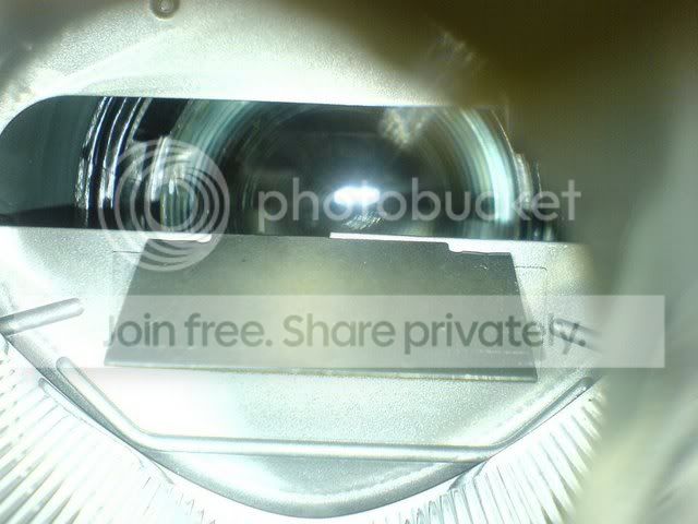

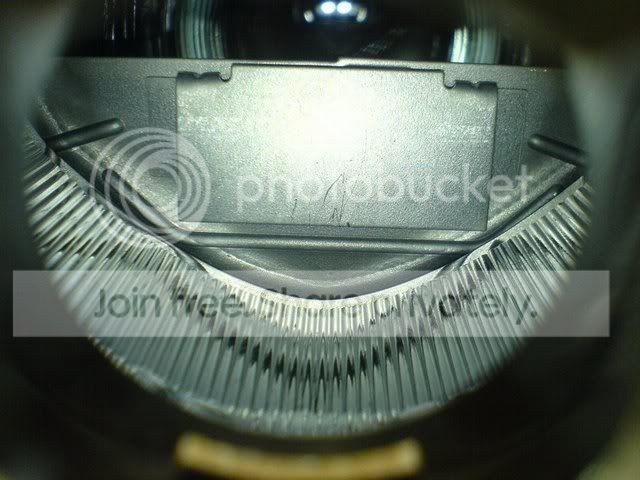

This is what the 'unmodified' projector should look like(this is a camry projector)
this is what it should look like after

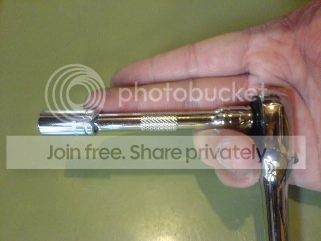

simply use a 'poking device' longer than your fingers to push the tab all the way down

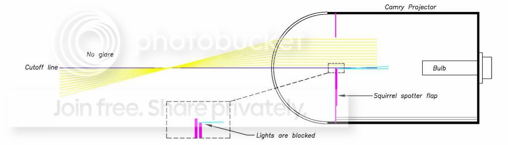

Now this is considered a 'quick fix' and some of the glare still manages to get through a slim crack that remains, heres what u can do for a much better fix
http://www.toyotanation.com/forum/sh...=192949&page=2
this is how they work
hope this helps, all curtesy (sp?) of the peeps at toyotanation!!

But do the squirrel spotters really cause glare? Because even without HID's these have the squirrel spotters, same with almost all Toyota/Lexus projectors. I would imagine they wouldn't be there if it caused glare.
Also, on the quick fix idea, if you bend that flap down, it looks like it couldn't be put back into place if needed?

yes, even with halogen, the squirrel spotters are still there, but the lumens are 4 times less intense, therefore the reflection of the divider is not as strong, so it doesnt botter oncoming drivers, when u stick HID's in there, the intensity of the squirrel spotters becomes a problem,
once the tab is bent, there is no going back
