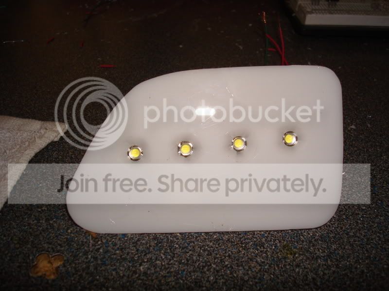

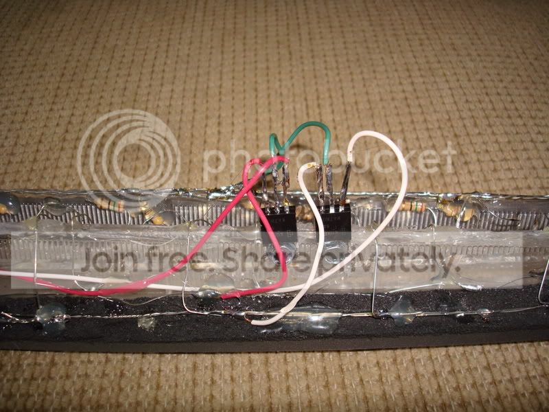

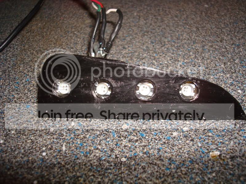

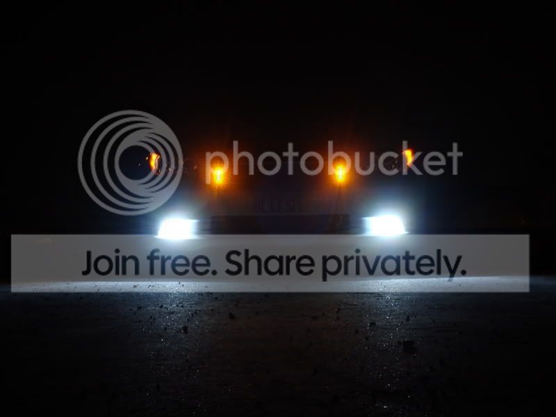

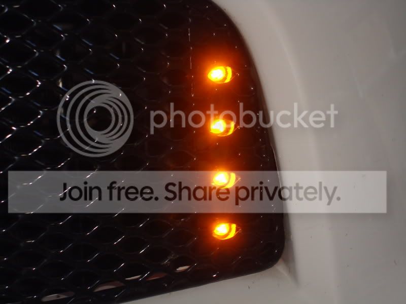

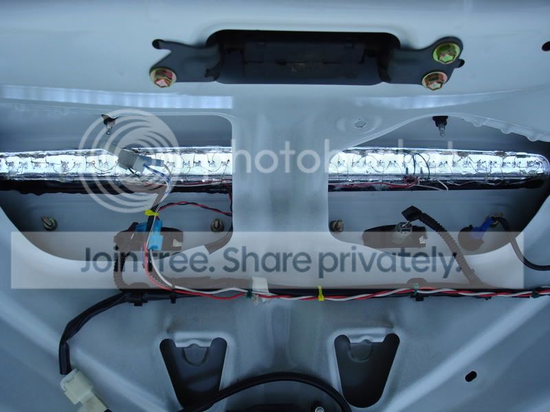

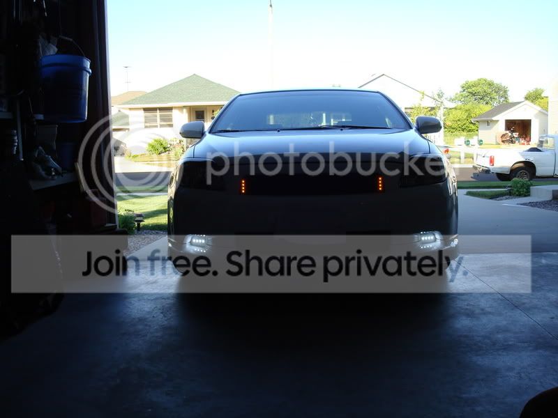

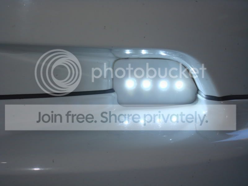

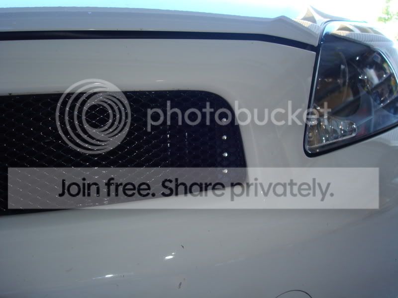

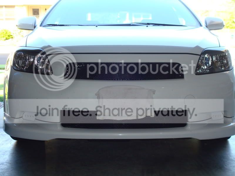

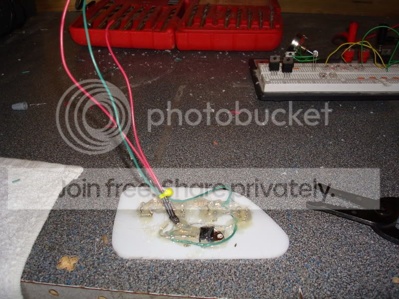

aight, well this first off started w/ redoing my 3rd brake backups w/ the besthongkong 100ma white superfluxe( left the back off so i can mod it w/ it inplace.. lol.. well, then i liked them too much so i redid my custom led fogs w/ these as well and put them in some custom white plexi instead of the black stock vent i had the previous version drilled into. . then i had some of the 80ma ambers so i custom made some mounts for them. since they strobe, and are expensive as hell, i regulated them as well as diode isolated them for the sho-me strobe kit.

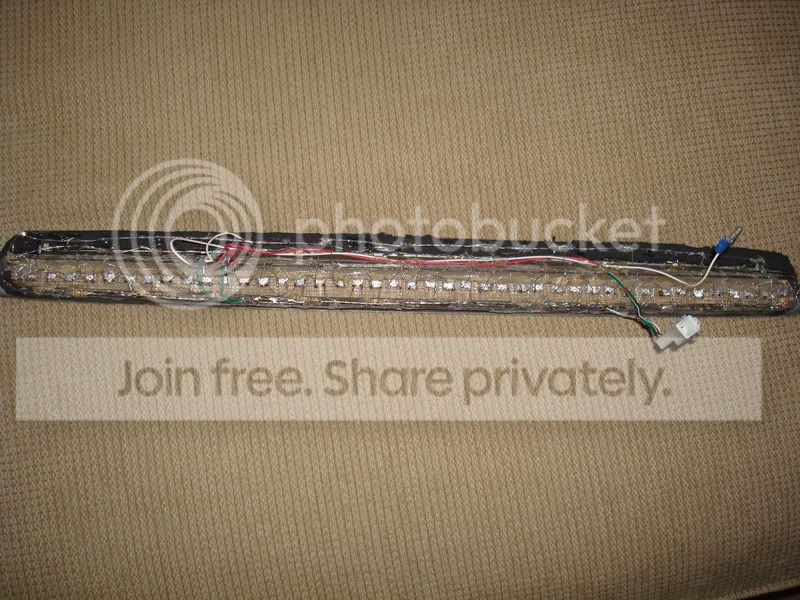

So is your TBL white or do you have a red overlay?

thanks guys. the TBL has the stock lense. just modded w/ red and white led's

tell me about it.. but i bought knockoff first.. learned my lesson, then bought the real deal.. the led is solid metal inside so it dissapates heat like no other.. thats the true test of the pirhanna's..
