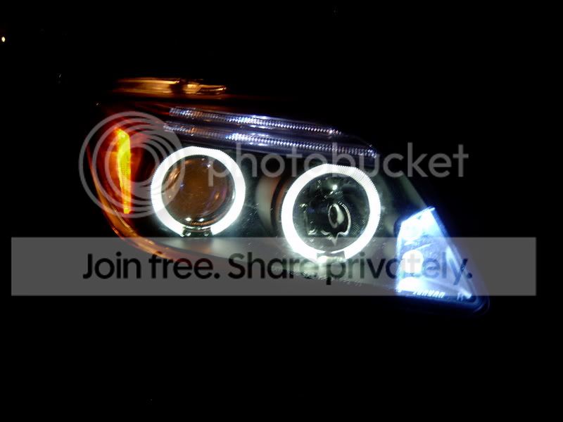

those projector lights, have 2 white cables and 2 black cables for the 2 small blueish lights, and the 2 angel eyes around the lights themselves... where do you suggest those wires attach to then?
where do you suggest they go if you dont, 1. have a switch to turn them off or on.. or 2. want to control them independently of the headlights..
I didnt install them wrong.. I installed them exactly how I wanted them to work.
I have mine spliced into my parking lights, so that when they are on..they look like this
Old Oct 23, 2006 | 05:20 PM
