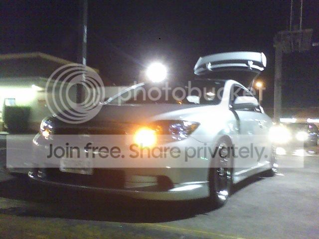

ok guys im going to be buying some wires today and a relay to try out the diagrams and ill let everyone know how it goes...
sciontc_06: in the pic you posted
that is exactly what im trying to do however i want the turn signal bulb to blink when the headlights are off or on.... and i only want the turnsignal bulb to light up like that when the city light and/or the head lights are on (they should still blink also meaning the turn signal)
how ever... make a diagram of what you did...to better explain your post..
ill be buying stuff and trying out some of the charts and will come back with results guys..
