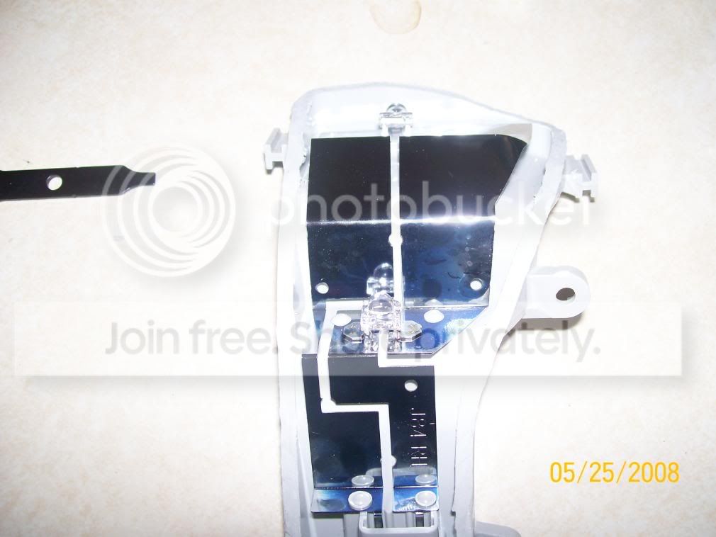

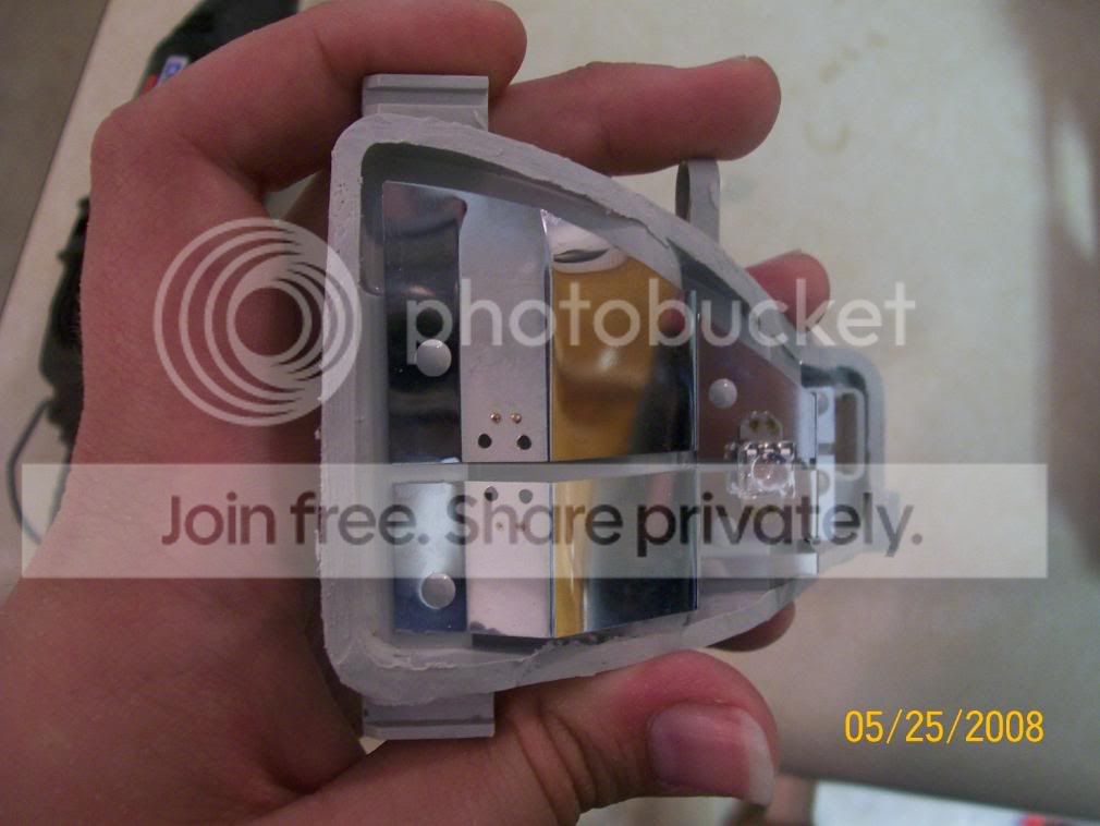

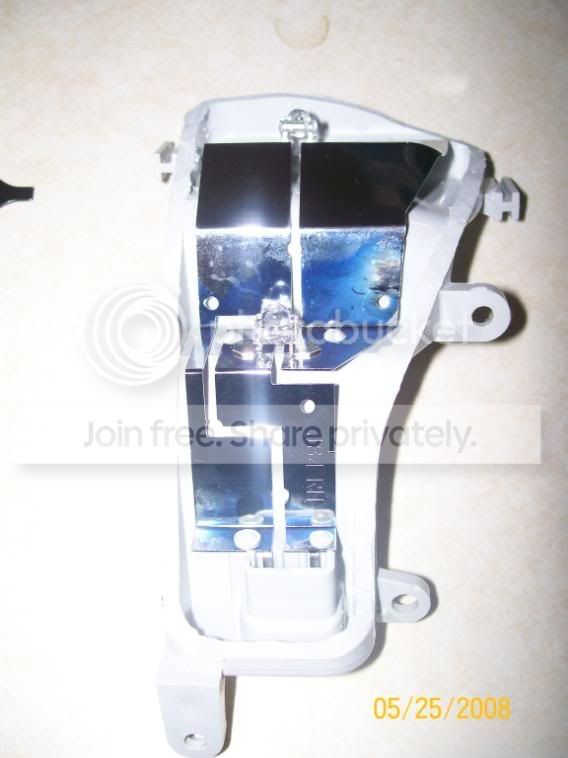

ok I did my wifes car today and i did it a different way. I used a 1/16 drill bit and drilled pilot holes for the LEDs and it was a lot easyer. I didn't have to worry about holding the LED in place, it set on there in the holes. hear are some pictures of the way i did them. in the 2nd and 3rd pictures you can see the OEM LED on the bottom and the new 5 chip LED on the top.
