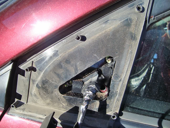

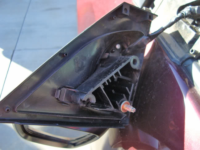

Okay, I found out on another board it probably needs 3 10mm screws and a plastic mounting bracket replaced. Are mounting brackets just generic pieces or do you need specific ones for a TC?
And yeah, tape is a no go. It's way too heavy for tape and it might ruin my paint (ack!).
Here are photos:
Size:  48.8 KBName:  DSC00252.jpg

The only thing you're going to be able to do is replace it. Try to find one in a junk yard if needed and just swap the colored covers - or buy a new one. You're looking at around $150 or $160 for a full replacement. They do not sell the parts for them separately.
Old Dec 23, 2009 | 07:49 PM
SquallLHeart's Avatar
Posts: 15,699
you can probably jbweld the studs back in..
the damage doesn't look really bad at all.

Yeah I had to buy a new one. The inner mounting part was too cracked to glue it - the edges didn't fit evenly, and so the screw couldn't stay in well.
I got one for $100 here ($12 shipping), with matching color: http://www.ftoemperformance.com/. These instructions w/photos were really helpful: http://mikeandlisa.wordpress.com/200...t/#comment-783
It took like 5 minutes to put on. Very easy.
