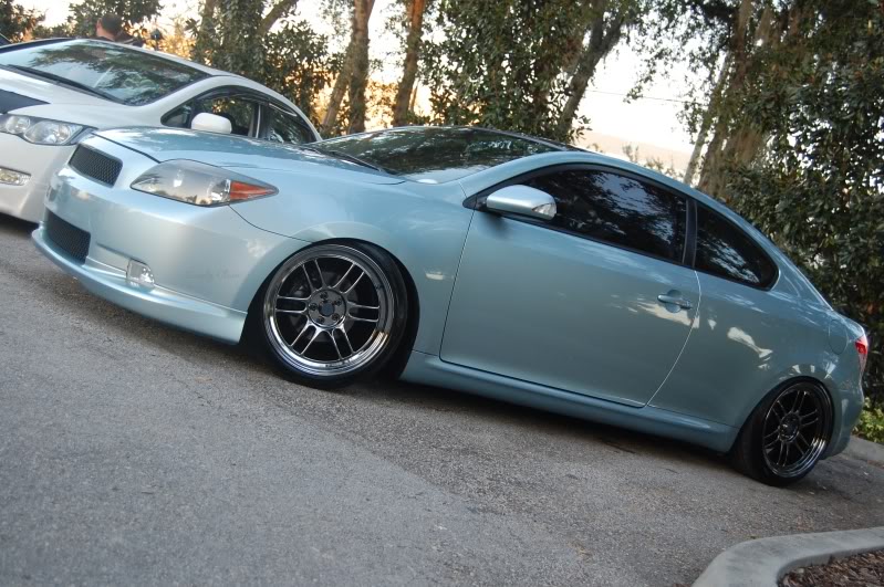

Azure pearl?
i acctually just painted my front lip myself buying aerosol colormatched paint from here
http://www.automotivetouchup.com/
bought the clear coat aerosol too and it was super easy to apply, maybe you can just aerosol the clear coat and save yourself the headache.
heres a pic to see the color match, it was spot on!
good luck!

minter 66: Looks good, make sure you take some pics when they are on the car.
chicotunner07: thats clean, i actually wanted to paint a spoiler myself. How did you prep your lip before you painted it?

Chico, how many cans did it take for the front lip?
Old Nov 18, 2010 | 12:30 AM
chicotunner07's Avatar
Posts: 4,188
From: 954! oh yeah...
the lip was new primered from factory
first i washed with dish soap, dried then used prep solvent
then used a fine scuff pad and rinsed and dried again
used prep solvent again
3 med coats of primer (bought from automotivetouchup.com)
4 med coats of base coat
and 3 heavy coats of clear coat
i came out really glossy, i had fine grit paper ready to wetsand and polish but its seriously not needed in my case!
Jon, i used half can of primer, 1 full can of base coat (had a tiny bit left), 1 full can of clear (had about enough for half a coat)
Old Nov 18, 2010 | 12:32 AM
Posts: 4,188
also, 15-20 minutes in between coats, weather was 80* and 45-55% humidity (a rarity in south florida) and i did it in my garage
took me about 6 hrs with all the waiting in between coats.

Originally Posted by chicotunner07
also, 15-20 minutes in between coats, weather was 80* and 45-55% humidity (a rarity in south florida) and i did it in my garage took me about 6 hrs with all the waiting in between coats.
your lip turned out good didnt know you painted it yourself. nice job on the paint. i didnt the same with my whole rs1 lip kit. but i used duplicolor perfect match paint for autozone. best aerosol ive used other then www.automotivetouchup.com.
and like chico said you could use the clearcoat from there, there clear coat is good for aersol clear. or you could use the clear coat i used on mine turned out really glossy as well. i just used duplicolor perfect match clear coat. also great stuff.
Old Nov 20, 2010 | 01:56 AM
Posts: 4,188
thanks!
ive used automotice touch up before, but for small pieces, like mudflaps, and trims, never tried painting such a large piece, i honestly could not be happier, and i spent 40 bucks on 1 can of paint, 1 can of clear, and 1 can of primer, how can you beat that! lol
