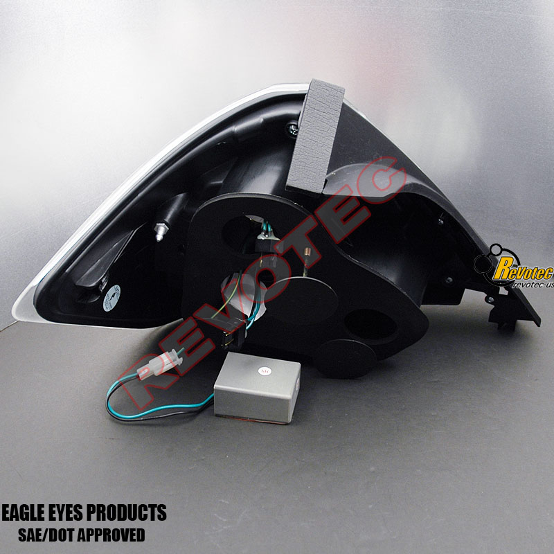

FLINTstone's Avatar
Posts: 1,587
judging from this picture i grabbed from ebay i think the set i have is an older one. ive heard you need resistors to stop the turn signals from hyperblinking. this newer set has them and mine dont...
tctctc does yours have a grey box attached somewhere on the tails?

i bought them from a member here on the boards. after doing some research i am indeed missing a set of resistor units that plug into the plug im missing!
these are fairly common and i can order them from superbrightleds.com. thanks all for the help and input!
