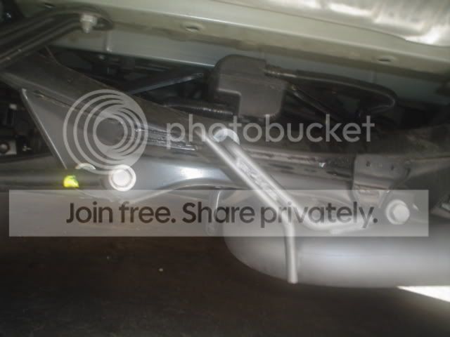

Do all the hks hi power exhausts for the tC hang low (theres about a 3-4 inch gap between the top of the tip to the body)? I just installed mine last weekend and just wanted to know if that was proper. I also didn't lower my car yet, but if I did, I think I would for sure scrape my exhaust.
You might want to try replacing the hangers with a shorter and stiffer rubber hanger.

There is a large gap between the tip of the muffler, or the bend in the elbow? Are you sure you have all the hangers on?

Should I get another hanger for this as well?

woah. that dont' look right to me.
There should be another hanger closer to the actuall canister. Is that on correctly?

yup doesnt look right, way too low.. check it again or else you need need new hangers
It should of came with an extra hanger that you mount on top of the rear crossmember(I think thats what its called).

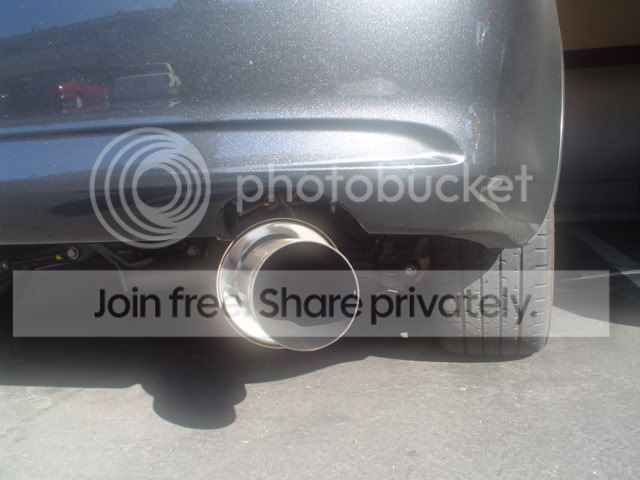

the HKS posted above is missing the extra hanger supplied with the exhaust.
here are pics of mine, its really loud since i have no resonator i love the look tho, i have always hated slanted canisters, but i think my car pulls it off:
^ my tires are 245mm wide, so that is a good example of just how big the 6" canister and 5" tip really is.
