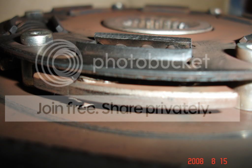

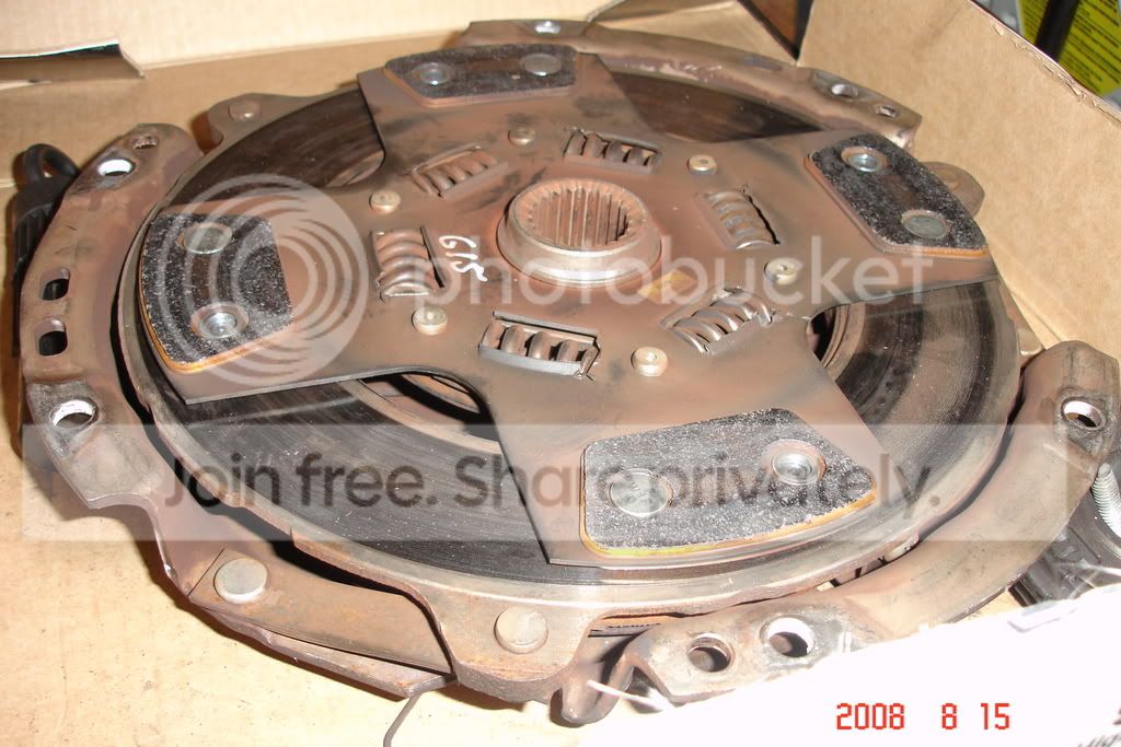

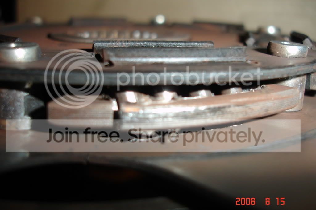

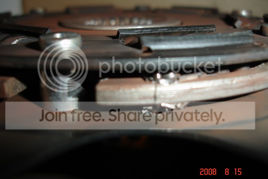

I had a Clutchmasters FX400 4-puck in my car when I made around 250ft-lbs at the wheels (on a dyno dynamics). I drove my car in a lot of stop-n-go traffic and opened it up everytime traffic dissapeared, and on top of that went drag racing this summer. Well, it finally died on me when I got retuned last month. On my last pull on the dyno the sprung assembly failed and my car didn't go into any gear; the car makes 60ft-lbs more torque from the original tune. For a performance junky like myself, the puck clutch didn't phase me in terms of drivability, although I can tell you the pedal pressure is def more than stock and launching the car is tricky if trying to go slow. This clutch lasted for almost 8 months. Failure points below:
I now have a Clutchmasters FX300, the carbon kevlar one, that has a lot smoother engagement and after a long tedious 500 mile break-in period, I can tell you handles the power I make with no problem. I really didn't want to go away from a puck clutch, but my tuner convinced me this clutch is more than up to the task. I can now drive around like a normal person and if the need arises open her up a little... okay a lot.

holy hell, you worked that one well enough. glad you got something new.

bigAl...you had a S4, it only lasted 8 months, so you replaced it with a S3? Doesn't that mean this one will last you less then 8 months?

It honestly depends on his use of the clutch. True, ceramic would be tougher and technically last longer, the kevlar, should be take care of it, would actually last a little longer, have a better feel, but would have a lower tq capacity in most cases.

Quite honestly, the pictures show failure points that you can most certainly point at bad metallurgy - the picture below actually shows the clutch disc. The ceramic doesn't even look worn. I decided instead of having a clutch that can handle 500ft-lbs of torque, I would try one that can handle 390 ft-lbs of torque; still well over what I am making and I don't plan on building my motor any time soon to go over that figure. All the while, improve the drivability of the car since it is a daily driver. But I also heard a lot of good things about these carbon kevlar clutches. So instead of being ignorant to the fact, I went and got one and now you guys can have my 2 cents on my experience with it - which by the way is fantastic.
