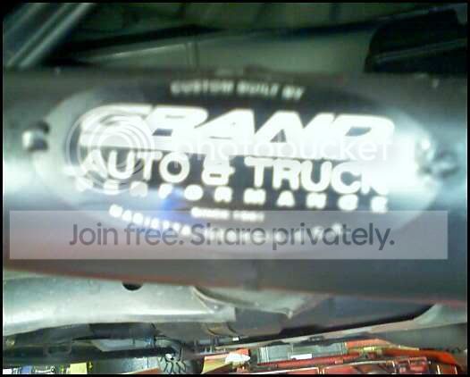

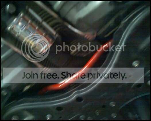

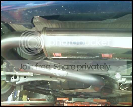

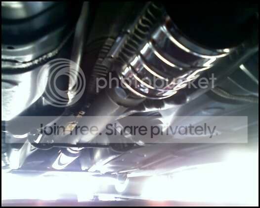

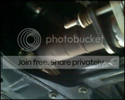

here a few crummy shots with the phone, I'll clearer ones with the sound clip.

that looks like a sweet mandrel bent setup. They did an s-pipe for you too? Good shiznit. No one around here mandrel bends. all of the places I have asked crush bend the pipe, so you get the ridges in the pipe at the bends. I can deal with some mis-fitting pipes if it means going with crush bent.

yeah they did do an S-Pipe for me,
