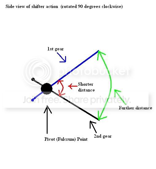

cutting your stock shifter will work just the same as buying a shortened shifter. where do you think the companies that make short throw shifters take length off of? look at a comparison of the two:
stock is on the left, twm short throw on the right. everything is almost identical with the only exception being the length of the shifter from the pivot point to the **** threads. they can really only shorten the length from this area. if they shortened from the lower half the shifter cup would not actuate the shift linkage far enough to engage a gear. And it really is simple geometry. the closer you are to the pivot , or fulcrum, point the shorter the traveled distance becomes. and the same is true for the opposite, the further away you are from the pivot point, the greater the traveled distance becomes.
Here's a crude diagram to illustrate the point:
so for the issue of cutting your stock shifter in hopes of shortening the throw, it will work. but for a stiffer, more direct shift you will want to invest in upgraded shifter and cable bushings. if you cut the shifter and do not replace the bushings you will still have that soft, mushy feeling in your shifts.
Make sense?
