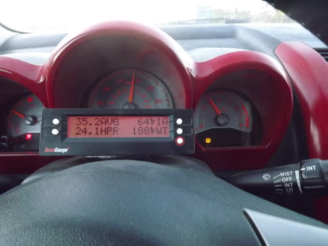

this is what i avg. on my car with the e351, I usually do anywere between 30-34mpg, I was going downhill when i took this picture
