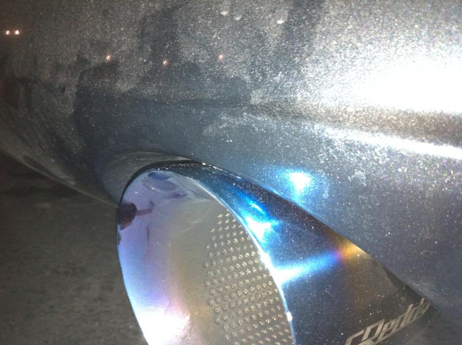

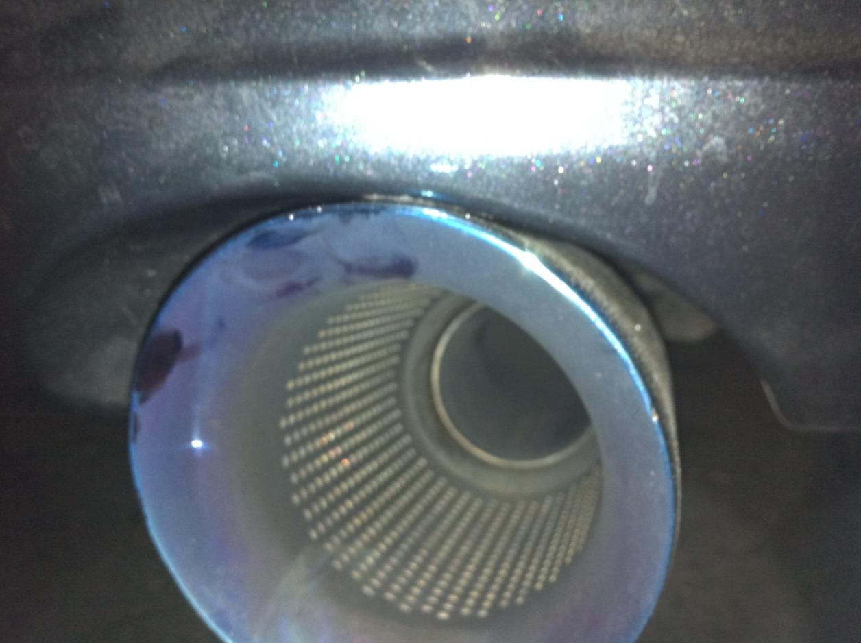

Pictures attached. The bottle cap will work for now.

I'd probably add a second bottle cap, looks a bit close still. Keep checking on it after going for a drive.
This was before I put the bottle cap in there. It has about the same clearance as the stock exhaust did.
