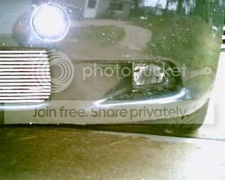

Awesome, my car isn't much for show, its too hard to keep nice. I live on a gravel dusty road, so as soon as i wash it and drive away its filthy again, so i gave up with giving it the clean look. But definately post them pics when you get it

similar.. its just a couple ram air hoses that i rigged out of dryer hose but work very well! The filter is actually made for ram air, and i ran the intake hose to the bumper where the filter normally goes on a true CAI

I've had it for several months, and yes through very heavy rain. No problems whatsoever. I assume by SWR, you mean secret weapon R, If so the filter has an adapter on the end that i clamped a hose to and ran it down through the fender wall to my front bumper grille insert, look....
