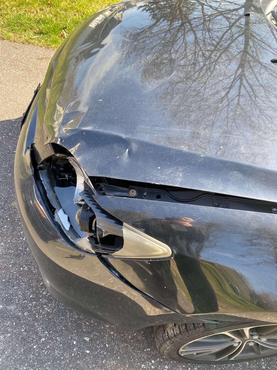

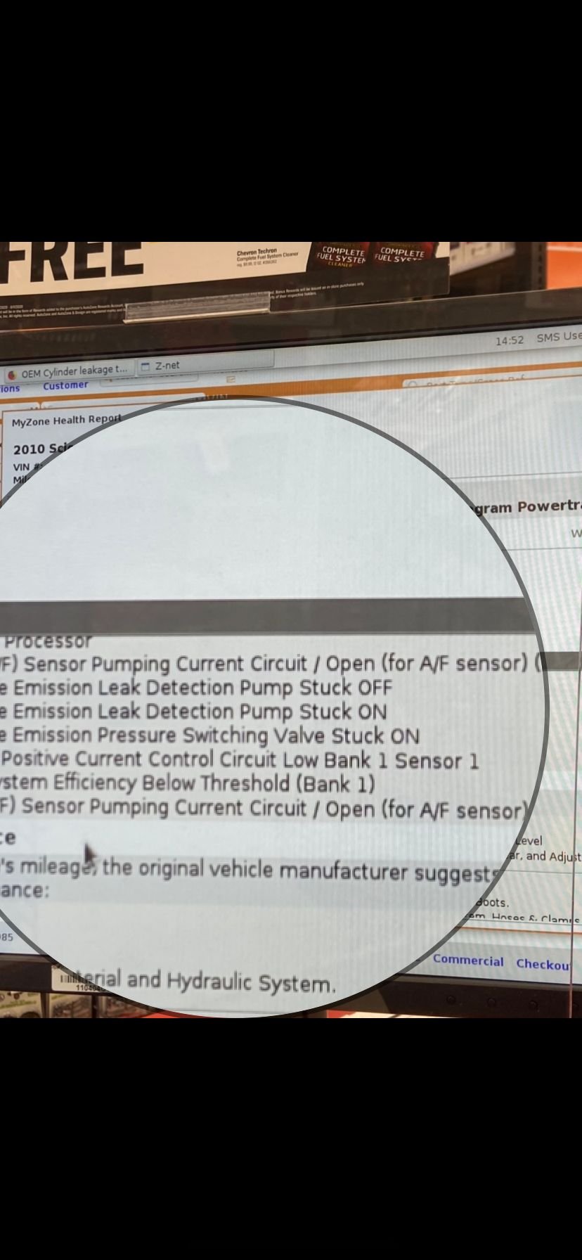

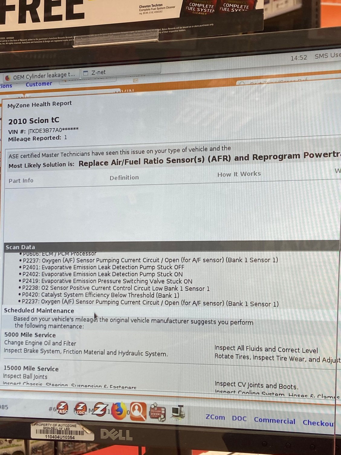

Hey everyone I have a 2010 tC and the reason I signed up for this site is I’m a mechanically inclined person but not a car mechanic. I was involved in a 3 car fender bender and ever since have had check engine. The damage on the front is the drive headlight hood bumper fender area and I don’t know if or how this triggered my issues. I just need to figure this out because my inspection is up, I’m attaching the photo of the screen Auto Zones Code Reader came up with keep in mind I changed both O2 sensors (8-10 months ago) and Mass Air Flow sensor (a week ago) I’m attaching photos of the car and the codes please give me advice I don’t know where to start but as an electrician I feel like the problem has to do with the condenser being pushed back which pushed the battery back causing a right fit on my positive wire harness, or maybe the hood being bent open caused water damage to a computer, any advice is appreciated

You need a print out of the "scan data" section of the report. That should give you all the trouble codes that tripped your CEL. I can see several codes in the pic but I don't know how long the list scrolls. Once printed (or written down) you can take the list to a trusted mechanic who knows how to prioritize the codes and investigate each one if necessary. The collision might have whacked one or several electrical parts. Might have also whacked a common ground that's affecting your various codes.
