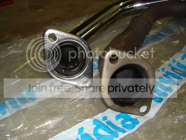

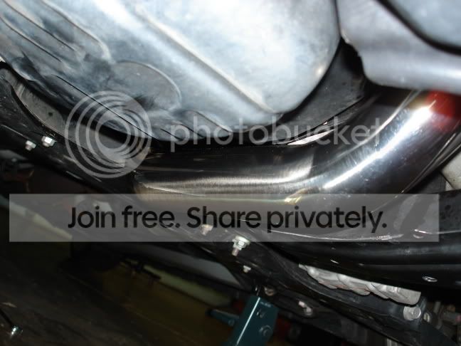

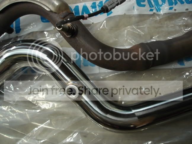

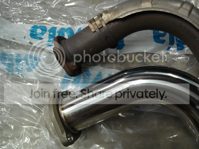

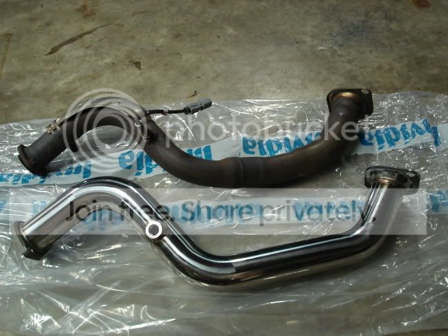

i installed the invidia pipe on my car. the stock pipe at its biggest point is smaller than the invidia. you will notice in the pictures how the stock pipe starts off at one size and actually gets smaller half way down.
yes the invidia pipe fits perfectly. i'm actually still using it with my turbo kit. the welds are flawless. and believe me i know a good weld. i use to be a welder. this pipe is definatly worth the money considering the quality that you get. i also got mine from ultrarev.com.
