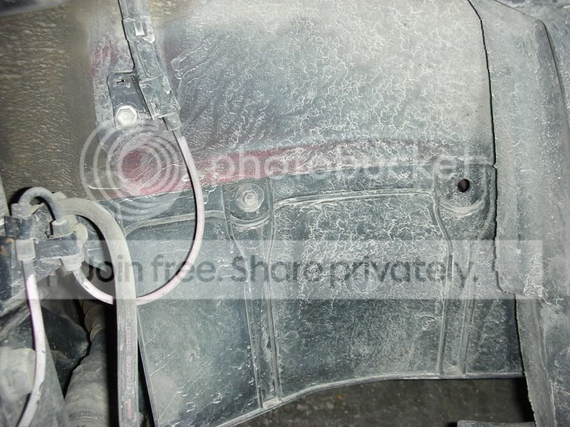

With the tire off, I was able to access the screws and plastic rivets I needed to remove to take off the inner part of the wheel well to access the pulley. You can see one of the screws in the picture below and a pop rivet is behind the brake line.
Another screw is accessible by pushing the wheel well liner back a bit. Then, I got under my car to get the rest of the fasteners. There is a pop rivet on the underside of the car that connects this piece to the splash guard as well as a "clip" that holds the top of the piece to the metal frame of the car. There might be one more clip to remove, but I can't remember off the top of my head. You'll be able to see it if you get under the car.
Once you get all of the clips and screws removed, you can pull that piece off the car. It will make things much easier later in the install. As you can see in the pic below, I left the piece on and just held it back while I removed the bolt holding the crank pulley on. I removed the piece completely later on in the install.

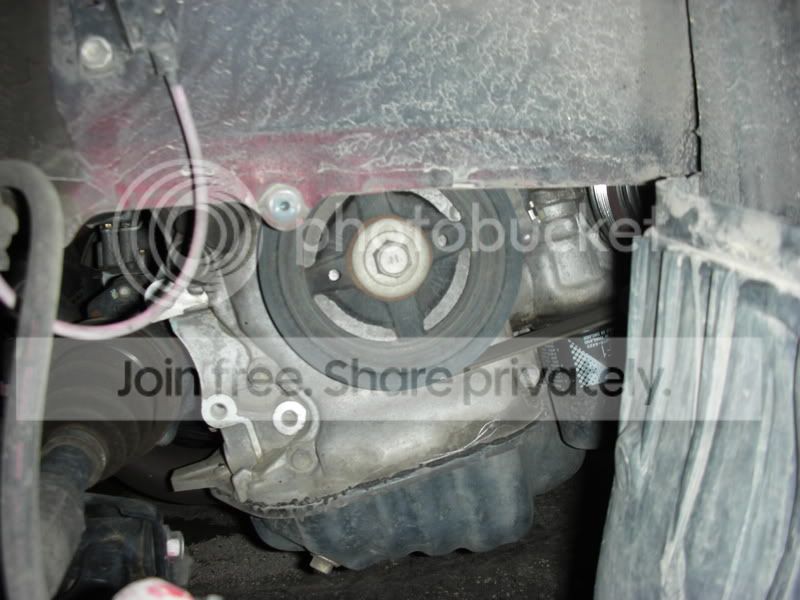

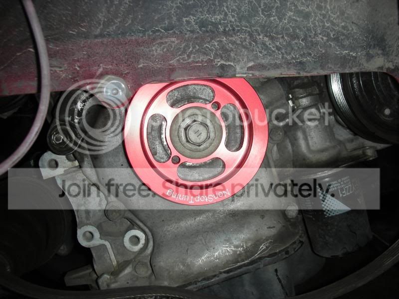

To get the crank pulley bolt off, an impact wrench works the best. I couldn't imagine doing this install without air tools.
Bolt on:
Bolt off:

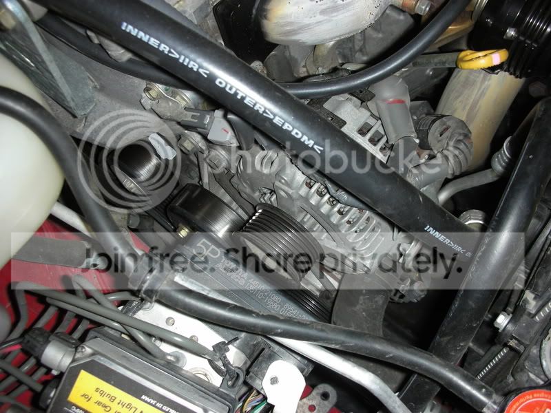

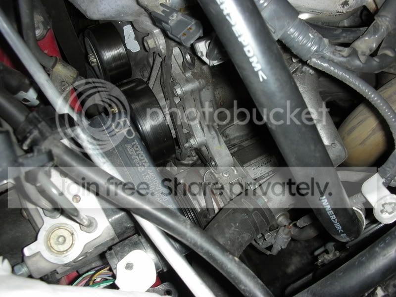

Here you can see (from right to left) the alternator pulley, water pump pulley, and tensioner pulley:

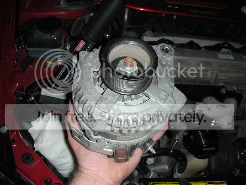

The alternator with the heavy stock pulley on it:

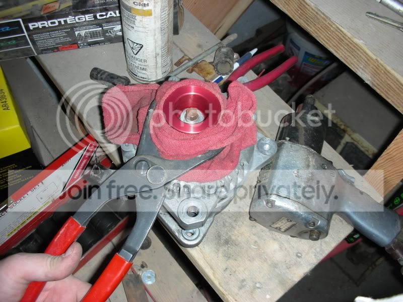

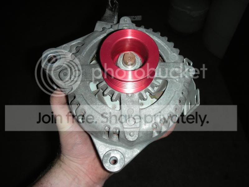

Getting the alternator pulley off is a bit tricky. There is nothing really to "grab onto" while trying to remove the bolt. I didn't want to clamp something directly on the pulley in case I needed to return to stock in the future. What I ended up doing is wrapping a rag around the pulley to protect the ribs. Then, I used a set of oil filter pliers to hold the pulley while I used an impact (air tools FTW!) to remove the bolt holding the pulley on. This worked perfectly.
How I removed the pulley bolt:
Stock vs. NST:
New pulley secured:

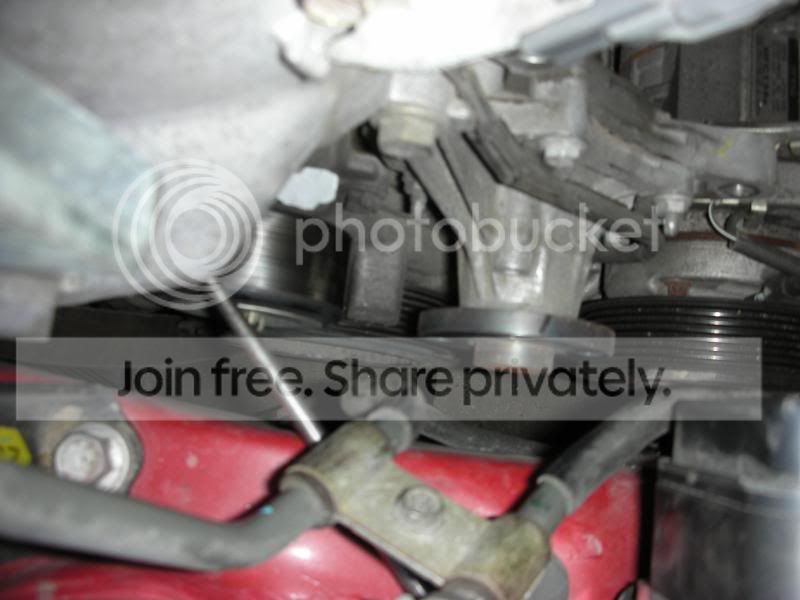

Next is the water pump pulley. This is where taking the coolant overflow reservoir off really helps. To keep the pulley from spinning while attempting to remove the 4 bolts holding it on, I shoved a screwdriver through one of the holes in the pulley and put the tip of the driver against the engine. Make sure you use the biggest screwdriver that will fit through the hole. I bent one screwdriver because it wasn't strong enough. These bolts are on tight. Chances are, a little more swearing will help you out at this point. Be especially careful when the bolts break loose because some of the swearing was caused when a bolt broke loose and I donated some flesh from my hand to the engine. Wear some gloves if you have them to prevent this from happening to you. Once you get the pulley off, you can either store it with your alternator pulley or choose to throw the thing across your garage. (I chose the former, though the latter was definitely looking like a good idea at the time.)
Water pump sans pulley:

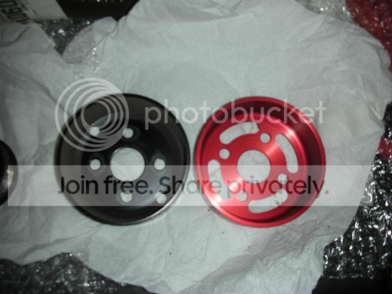

Pulley comparison. Though they look similar, the NST pulley is a lot lighter:
Getting the pulley back on is a bit more difficult because I couldn't find a screwdriver that would fit through the slot and keep it from turning. I started out by threading on all four bolts by hand. Then, I carefully put a screwdriver vertically across the face of the pulley and used 2 of the bolt heads to keep the pulley from turning as I tightened the bolts. Be careful not to scratch your new pulley if you use this method to tighten the bolts.

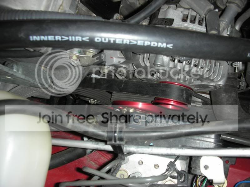

Water pump pulley secured:
I found the way that worked for me to get the alternator back on is to put the long bolt that is towards the back on first. Once I had this bolt threaded in and finger tight, I got the bottom holes lined up by rocking the alternator up and down. It seemed this bolt was a bit easier going in than trying to get it out.
Water pump and alternator pulleys:

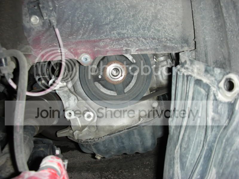

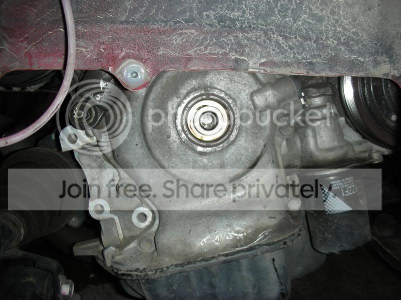

At this point, I decided it was time to return to the crank pulley. The pulley I did on my friend's car was easy. Took the bolt off and the pulley just pulled off the shaft. My pulley was having none of that. It didn't want to relinquish its job of turning the engine's accessories. I tried using a gear puller to no avail (the only ones in my dad's shop were used for pulling tractor gears and were large and cumbersome to work with). I ended up using two large flathead screwdrivers. I placed one under each side of the pulley and gently "rocked" the pulley back and forth until it was loose enough to just pull off.
Crankshaft minus pulley:

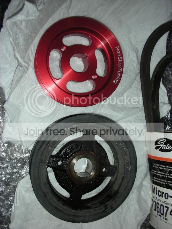

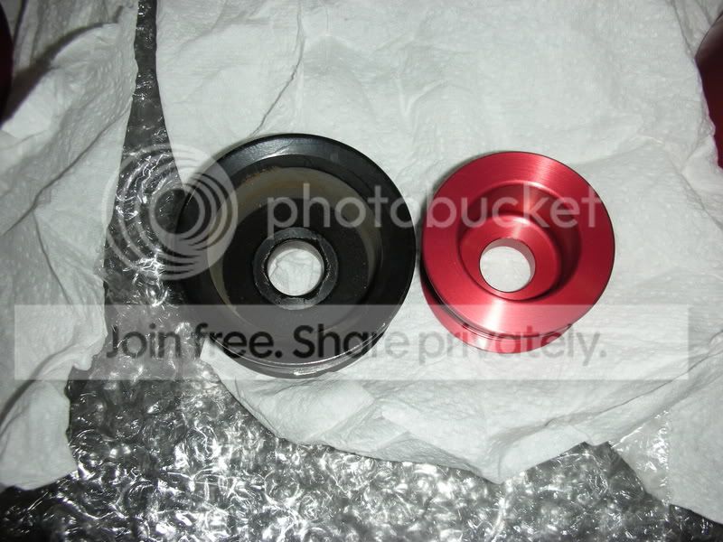

The stock pulley is very heavy compared to the NST counterpart. I knew there would be a weight difference, but I was amazed when I compared the two:

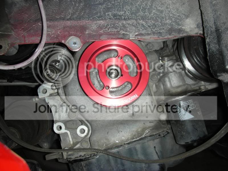

My pulley was pretty tight going on. I used a rubber mallet to lightly tap it on, checking often that they key was lining up with the groove on the pulley. Once it was on, I used the impact and put the bolt back on.

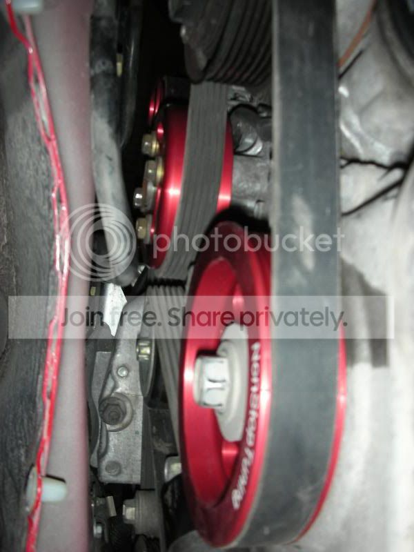

Crank pulley mounted:

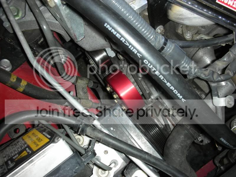

Now came the fun of getting the belt back on. Put your new belt on the pulleys. If you can't remember how it was on before, your instruction manual should have a belt diagram. Get the belt on all of the pulleys except the crank. Call you friend again (promise them the first ride in your car with the pulleys on) and have him/her help you hold the belt on and make sure you have it routed correctly. Get down by the crank pulley and have your friend relieve the tension on the belt with the wrench again and carefully put the belt back on the crank pulley. Once you have it on, look over the belts again to make sure you have it routed correctly and everything lines up right. You don't want to find out you had the belt on wrong when you start your engine.

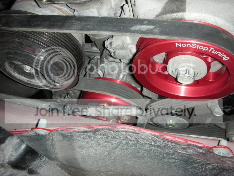

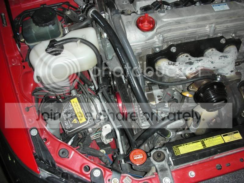

A few shots with the pulleys and the belt on:
Under the car looking up:
