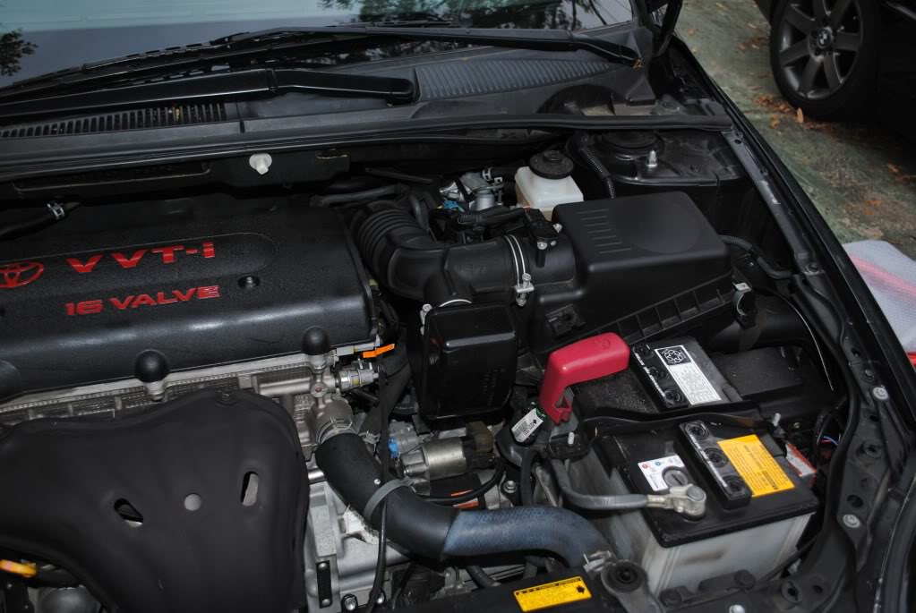

you should of also change the oil once that car got some water in it.. even though you may have sucked out most of the water, there may have been some that got mixed with the oil..its best to change the oil ASAP to avoid any further problems..
also clean the MAF sensor with CRC Mass Air Flow Sensor Cleaner.

Oil was changed forgot to mention that lol. It was done the day I got the car running again.
MAF sensor should be the one on the intake tubing correct? Right behind the box?

yep thats the one..
or here if your's an 07+
